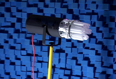

Yes you got it. I went through a big DIY phase 2 years ago which I documented in a video on building your own fluorescent video lighting. I'm enclosing a picture of my first prototype softbox fixture. I really couldn't believe it when I found the 200w unit. So much easier to use and includes the ballast. 84 CRI and 5000K are not what you really want but i'd rather have 5000K than 4200K any day of the week.
I've found that bulb to be super reliable too, compared with many of the other 200w self-ballasted chinese counterparts I've evaluated for selling on my site (I have a whole closet full of rejects). The Maxlite is still manufactured in China but the difference was that that manufacturer obviously has strict quality control standards and some weight to throw around too to get what they want.
The only negative about a bulb like the Maxlite is you can't use a dimmer with it. So you're left to using silk and other diffusion techniques to dim it down.
