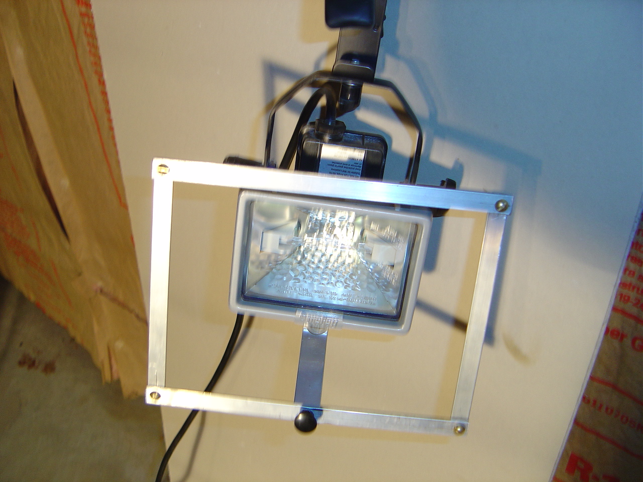

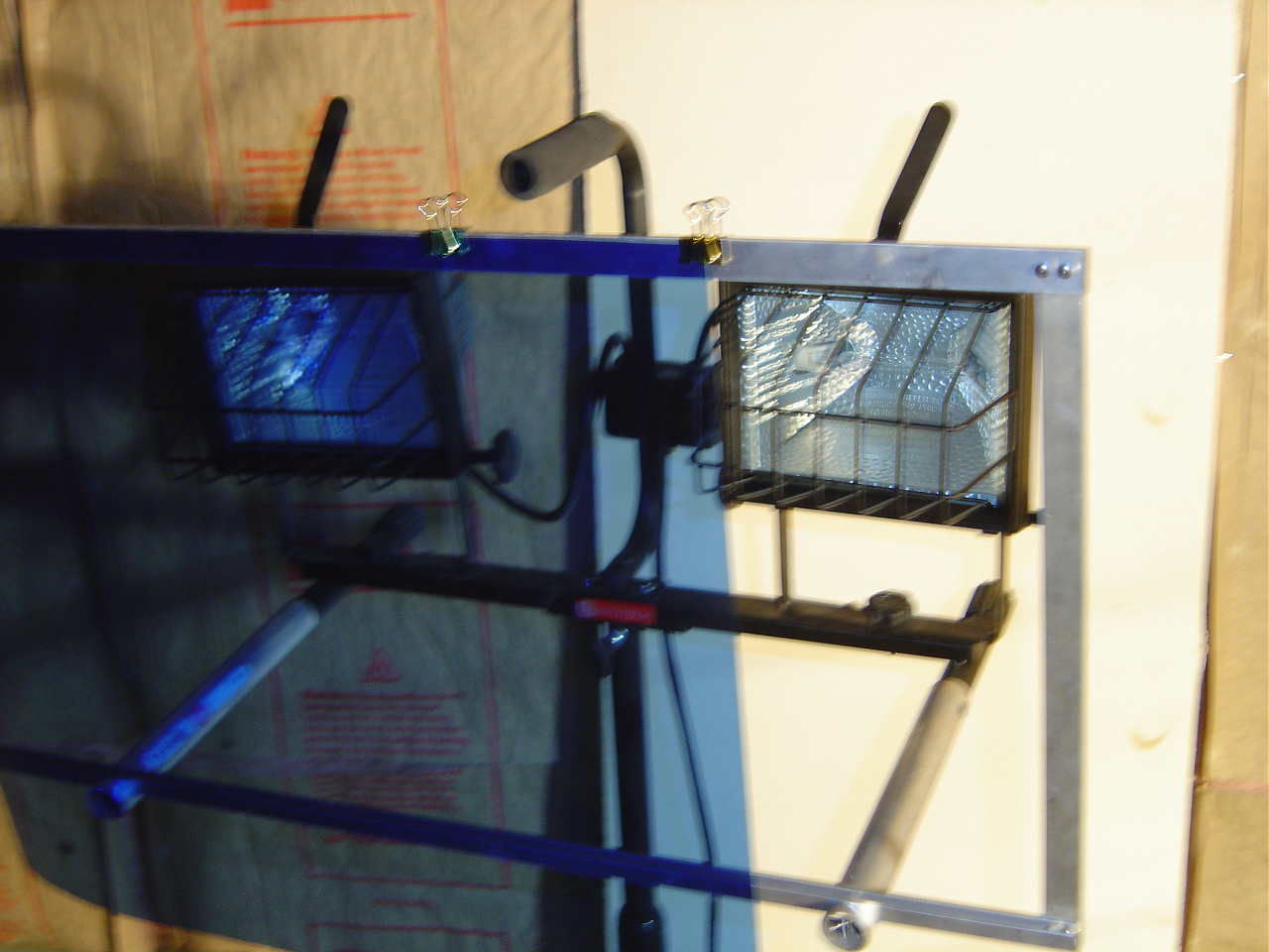

I thought I should have the abililty to do 5500K lighting to augment the sun coming through the windows and also the interior lighting, so I built a frame to hang a sheet of CTB. In testing the thing out however, the 110U reads only 5200K.
Is 5200K close enough?
Am I going down the right path on this lighting situation?
thanks,
Jon

If you can get a mirror reflector, put it outside and aim it into the back of the room. Blast it at a white surface, preferable a positionable white reflector, and you will get a 10,000W daylight-balanced softbox for cheap. You would be amazed at the light from a 36" mirror. This might need help from a crewmember to keep the mirror tracking onto your white surface, but it would solve most of your lighting problem.
Otherwise, 5200K should be fine. I think it's better to be off in a lower Kelvin rating than to go too high. 6500K looks horrible. 5000K just gives skin a slight warm look that may even be preferable. Just don't underestimate how much light you need to fight the sun. For an area the size of a classroom, you will need hundreds of watts of fluorescent. That's not hundreds of "equivalent" watts. You will need dozens of compact fluorescent bulbs unless you gel your windows with ND 1.2 (4 f-stop neutral density).
You might want to reconsider using tungsten with CTB. Unless they have better electrical standards than the U.S., you won't be able to get enough light for the amperage available. So much is lost into the CTB that you would need probably 4-5K of light and there are few buildings that will do that easily.

I like the reflector idea. I have one and will get another. I will be alone so will get stands and holders. I believe I can accomplish what I want on interior shots by properly illuminating a portion of the room.
Your comment on the CTB sucking up light was noted the first time I tried my system out. I must have missed that chapter when reading about CTB's. The 500 x2 lamps dropped significantly with the CTB.
Thanks for your comments Marcus.
