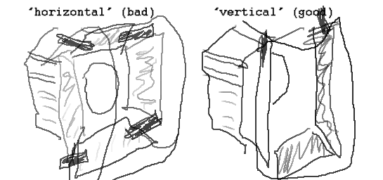

Gels are listed as "expendables" in any grip supply store. The reason being that they don't last since they are usually very close to the lens of whatever light you're using them with. I'm not sure what that means mounting it horizontally or vertically to get it to last longer. The first I ever heard of that.

Excuse the poor drawing:
http://glennchan.info/Proofs/dvinfo/mounting-gels.gif
Mounting it vertically lets heat escape.

thats true you may get two or three more uses out of them letting the heat escape, but thats about it, and even that is dependant on how powerful and how close to the light fixture they are.
