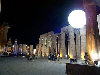

The Austrian company airstar makes professional china ball lanterns which seem to be floating like a helium balloon. They are used for sporting events like the biathlon world cup as well as film productions.
They look really cool and the light is beautiful but I guess they're a little more expensive than a 2.99 china lantern ;)
