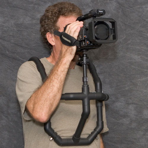

Here's what you want...it goes on both shoulders and would be 100% hands-free
Easy to make out of PVC tubing and fittings!!!
Chris

Thanks, everyone, you guys seem to know exactly what I'm talking about---and I SHOULD be able to do it myself....too many toddlers at home to get any handiwork done though. Chris, that rig is EXACTLY what I was thinking. How would I find someone to make me one? Or do any of you guys know someone? Or...I guess I could youtube it and then send a message to someone who has done one for himself.

That would be my thinking too!!! I saw this ages ago on a site and remembered I had the pic still in "My Pictures" .... As far as I remember the page also had instructions on it but just a trip to the hardware store and buy a few PVC fittings is all that would be required.
From the pic you would need a short length of PVC tube and then I can see 9 x 45 degree fittings, 3 x "t" joiners, 2 x 90 degree elbows and a 4 way joiner for the middle. Just a hacksaw and cut the pipes to length and push 'em all together ... the camera mounting would be a more personal thing but not too tricky at all!!! Once it's all looking good some PVC pipe adhesive would be a good idea.

Edit: Found the original author site : http://abracadabravideos.com/DIY/DIYpage1.htm

That makes it really easy to build - he mentions using "shears", I think there's a set of special ones to cut pipe quick and clean, if they aren't too much, those would be better'n a hacksaw, IMO. Also you can get the same fittings in 1/2" pipe, I see he used 3/4, probably would depend on personal taste, although I'm not sure about those "precurved" parts, might have to poke around to see if those are 3/4" only.
I liked the removable bolts to allow quick disassembly, you'd probably have to sand the ends of the pipes a bit, as I used a rubber hammer to get things to seat completely into the connectors on my project, and the fittings were fairly tight once fully seated. I found a clear glue (cheapest they had) for around $3.50, has a applicator swab in the can, easy to use, keep a paper towel for cleanup and you're good to go.
The telescoping camera mount is a good way around finding the "perfect" height for you personally, would probably save a bit of fiddling.
The most expensive part of the "budget" will be for a can of that "plastic" spray paint to make the rig look nice and finished, all the rest of the bits and pieces are cheap cheap!
