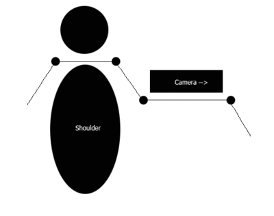

I'm looking for a shoulder rig with some capacity to adjust the height. Something *similar* to the Anton Bauer StatsisFlex but without so much flex.
I basically need it to adjust at the clavicle area of the shoulder. It terms of height, the height of the Kittyhawk is close but the ergonomics is not what I need: kittyhawk
The rig would have to support low- to medium-weight build cameras: one is a GH2 with a SmallHD DP6, and the other is a Canon XF100. Each build has one shotgun microphone, too.
Take a look at the attached picture for a napkin sketch illustration of what I mean. There are various reasons why I want this style, one being that I'm very tall, and want to be able to maintain my vertical lines without squatting all the time.

John, you might want to look at the DVMultirig at: www.dvtec.tv
I've been using one for years and the shoulder mount can be adjusted to fit just about any position you want plus with the spring rod it helps take the weight.

Your graphic shows the camera in front and no counterweight. For that situation (like with DSLRs), I find that I prefer a "chest rig", like Redrock's The Event, compared to a shoulder setup. I find that without a counterweight that the shoulder pad doesn't really anchor to the shoulder. But with a chest setup, I naturally pull the weight back toward the upper chest, locking it in.
If you plan on a system with a counterweight - never mind. :)

Thanks. I considered the Event but I don't think the angle's right for me. Given my height, I tend to shoot such that the, er, "film plane" or sensor is at the height of my clavicle, more or less, and I think I would like some additional support.
Thanks for the suggestions for the MultiRig. I'm giving it serious consideration.
The Extreme Deluxe is designed exectly as your scatch.
www.dvtec.tv
