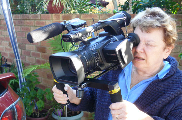

When I had my Panasonic AC-130's I found you need MORE than just a rig!! You also need a loupe otherwise you are trying to hold a heavy camera way out in front of you to use the EVF at the back. It's way more comfortable to have a rig where the EVF is not used and you put a loupe /eyepiece on the LCD.
Hoodman make one for the Sony EX1 and it fits on the LCD and has velcro to hold it in place and then you have a decent EVF and the camera is mounted further back and doesn't kill your arms.
Cine City in India (also on eBay Australia) have cheap rigs but still at least AUS$200+ !! Otherwise make your own out of aluminium rails and a foam shoulder pad.
Here is one with the AC-130 and my wife using it..worked a lot better than using the EVF at the back
Chris
Chris
