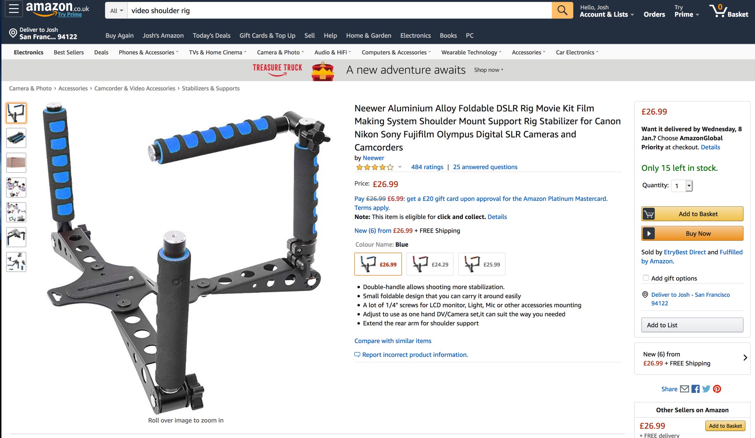

Hi folks. Over the years I've collected 4 different handheld rig setups. 3 that are were fairly budget like and one fancy custom built one that was so damn heavy I can barely use it. For run and gun (I don't exactly do the kind of shooting that has a first AC {or any AC}) it's murder on the body.
Anyway, believe it or not my favorite is pre-cage and all that. It's this oldish foldable Neweer rig (see image attached). Love the damn thing. Anyway, It hasn't ever been a huge problem but it absolutely needs an allen wrench to adjust a few elements. While I've always had one in my production backpack, I'd LOVE it if there was some way to have a super simply setup that had an allen wrench attached. Just a little plastic nub to slide it into or something. I could keep it on the bottom underneath the baseplate or something. Something snugly attached so it isn't swinging around while I'm moving and creating sound or additional slight tremors.

It depends on the size of the Allen key as to whether you could buy a spring clip small enough for it (the ones I'm thinking of are called Terry clips here), but this might be a good use for some Sugru to make a rubber clip, maybe even one that will pop into one of the holes in the rig if you're good enough with the Sugru. Good luck!

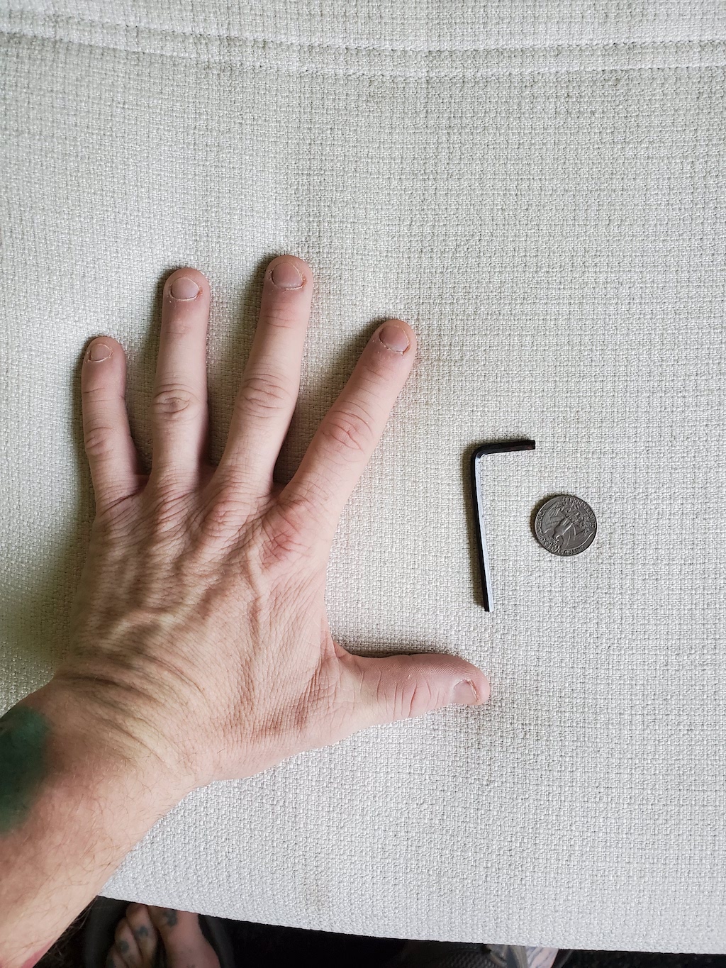

Hi Dave. I don't have the millimeter measurement but snapped this pic on the way out the door. Small size. Useful for bicycles and smaller pieces of film equipment I find. I'll look up Terry Clips now.

Drill a slightly undersized hole in a rubber block and cable tie that to the frame.

how about super glueing a magnet? allen wrenches are made out of steel right?

I hadn't thought of that. That might work. This handheld rig is metal so as long as a magnet was strong (and assuming it would attract an Allen Wrench, I might not even need to super glue it. That's a really interesting idea I hadn't thought of.
