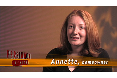

A suggestion I would have that is totally subjective is that you could tint the hair light more. I use Bastard Amber (that's what its called!). You could also light the background with a colored light, and maybe throw something in front to create shadows. A cookie, plant, blinds on a stand. All of that is subjective though. I thought the shots looked good. Here's a jpeg of what I mean, a still from an interview I did with my XL2...
Interview test footage / Need Feedback-annette2.jpg

Yep, that should work. I try to get my hairlights up really high, and angle it really steeply down. In the shot I included I'm using an Arri D4 kit, soft bank is the key, 150w for the hairlight gelled with... Bastard Amber! Ha, I said it again! One thing I had to get used to was really "skimming" the back of the talent with the hairlight, so that I too, didn't get that shadow below their face (the 150 was spotted, with only the gel, no diffusion).
My buddy who is a better DP than me always reminds me to turn each individual light on and off so I can see what exactly its doing for me, and I found this really helps to convince me that the hairlight is doing its job, and not over compensate by angling the light so it spill over too much of the talent and causes unwanted shadows. Hope this makes sense.
