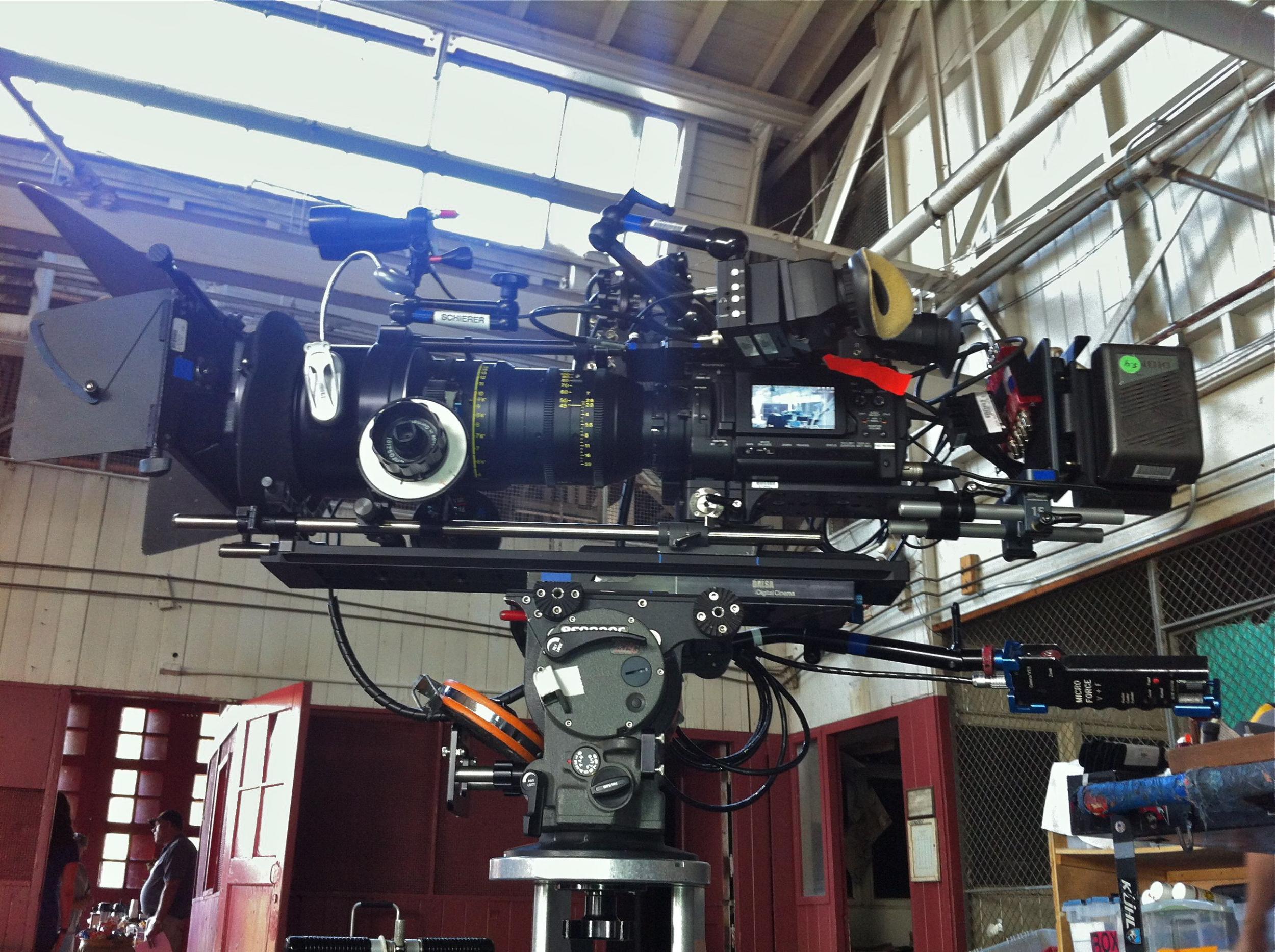

I've had no time to take any good set stills, but at least here's a quick iPhone pic of one of the cameras. I'll post more when I get the chance.

Thanks for the look at the rig, Charles. We appreciate seeing how you are rigging your cameras for these different shooting situation !
