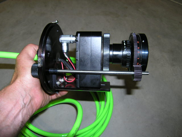

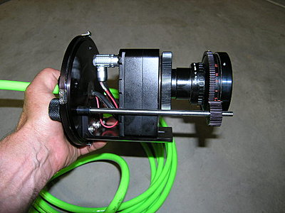

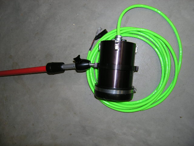

There have been several underwater shoots that have been done with the SI-2K Mini including for the BBC/Discovery Channel where the camera went into the rivers and waterways in Alaska to film Salmon.
The housing was built by:
