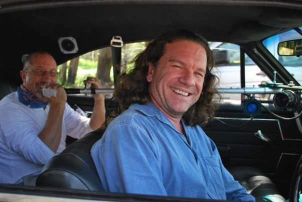

For those interested, here is the pole rig we used for the in-air shots a while back. In this instance it was used for in-car shots.
Camera operator, Steven Rice.
Driver-Actor, James With.
Pole front-end locates in a large foam wedge in the gap between windscreen and coaming (dash). The operator holds the other end.
FOOTNOTE: Image changed for one of better quality.
