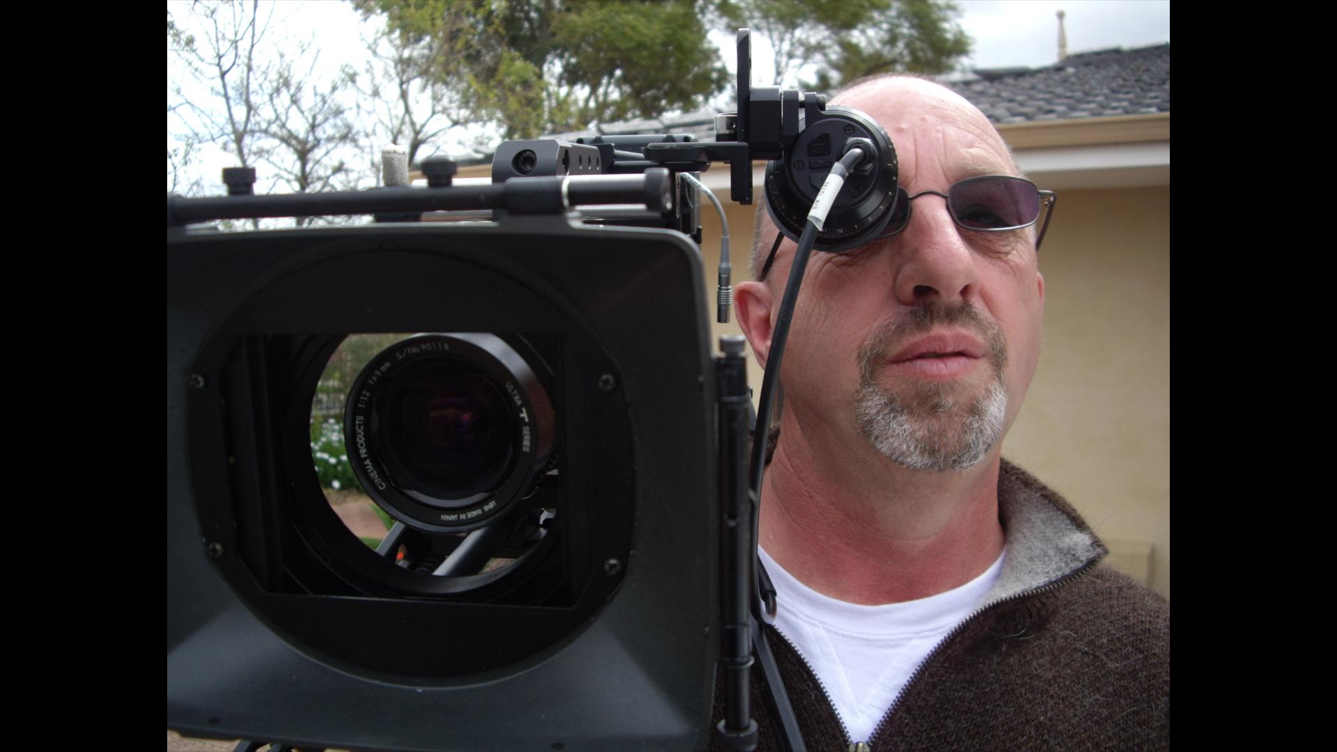

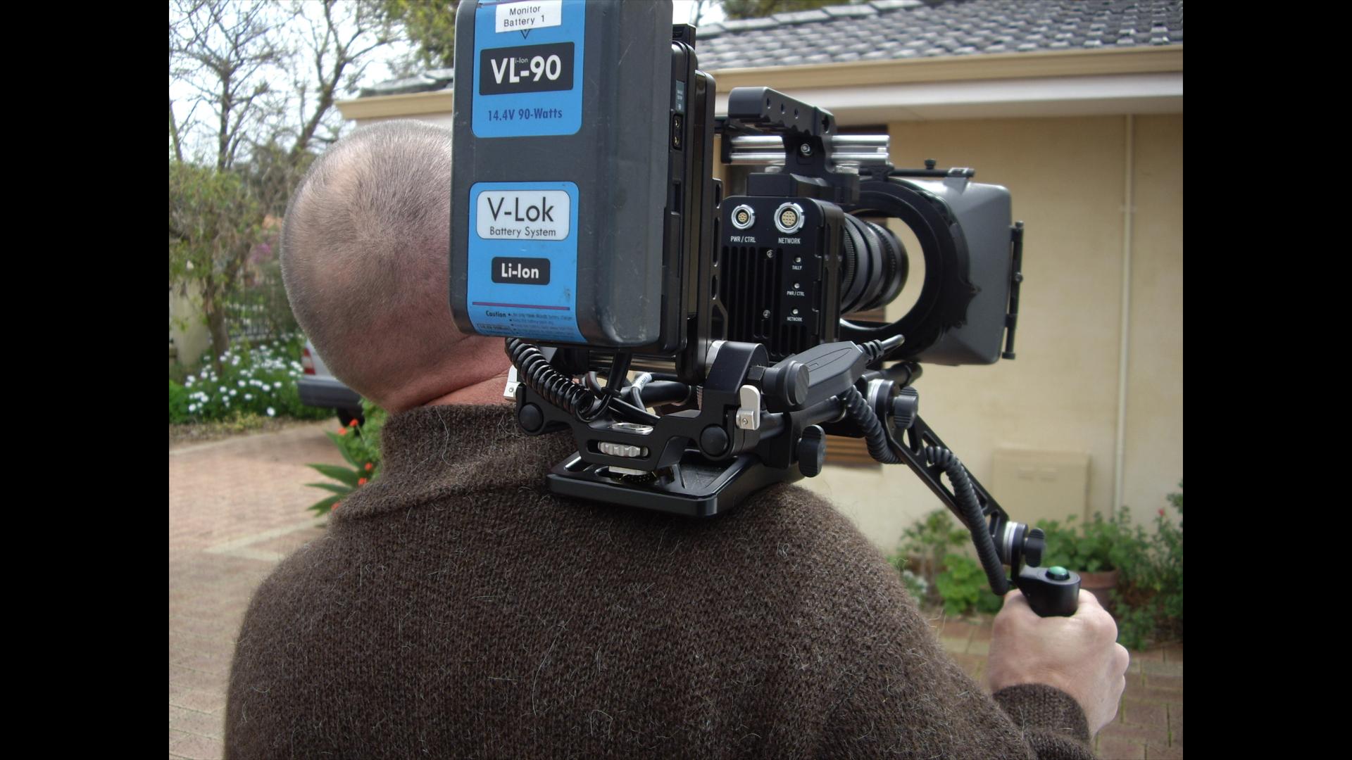

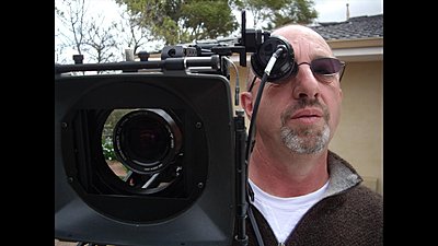

Si2k mini rig
The computer is playing fair tonight and images can be uploaded.
Yes, that is one of the those economy Jumbo matteboxes from the little guys over in Chandrigagh India. There was an earlier issue with 4x4 slide holders being a whisker too small for the slides to fit without some plastic having to be shaved at the edges. This has been corrected in the current product.
Alex.
Here are a couple of pics of the Mini rig. Some of the cabling and mattebox bits have not been fitted for these images. Until the laptop arrives, the camera is operated in the SI2K recorder unit.
A "rosette" is the beach umbrella type disk shaped fitting with bolt in centre with teeth formed in it which stops the object it attaches from moving. In this instance, one each to stop the long arms from moving on the rails and one each on the grip handles. The remote run switch is visible on top of the right grip handle.
Charles.
I am a bit of a dumb when it comes to steadycam, one of these "do I need to know this now - not right now" type situations, besides my left knee is pretty much shot, so it is an adventure I will not likely attempt.
Would the windage (air resistance) of an operating laptop on the sled with the screen closed, a 7" daylight LCD monitor where your normal green monochrome monitor would go, cause an issue for a sustained running follow like you describe? Would a solid sail of identical and opposite profile up at the camera end be needed as a counter-resistance to the resistance of the laptop during forward movement or in crosswinds?
SI-2K Mini in the Field-si2k-mini-03.jpg   SI-2K Mini in the Field-si2k-mini-04.jpg

Bob, the green button on the right-hand grip, is that a Record/Stop?
Where does it connect? I only see 2 connectors on camera, one power and one data.

Alex.
I would have to ask Steve Rice about the connections. He had it set up one day to the recorder unit body via the remote cable. That cable also supplies power to the camera head.
I'm not sure how the start-stop button works or if it works at all with the laptop arrangement.
