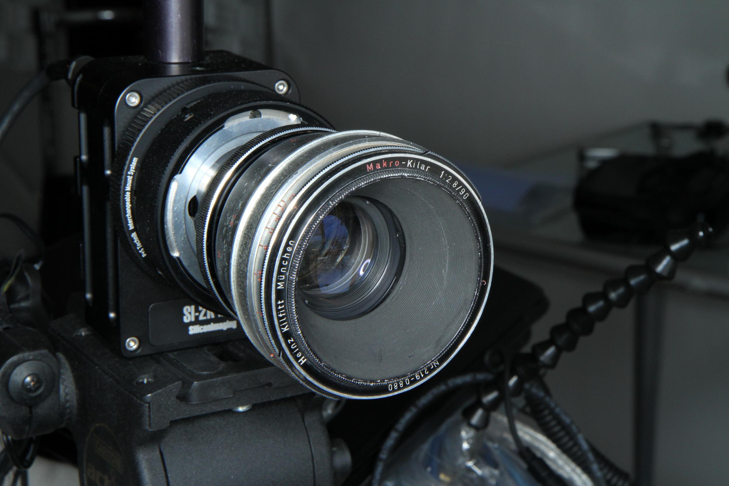

I just discovered Kilfitt Makro-Kilar F:2.8 90mm lens.
What a gem! (if you don't mind that it is a Kilar... :)
Works wonders from 1ft to 500ft, macro to telephoto, and everything in between.
A bit pricey but if you can grab a good one, I thoroughly recommend it for your SI-2K. Truly a fantastic lens.
Sorry for all the excitement, the lens is just that good.
And I hear this was the very first macro lens on the market, made in West Germany by Heinz Kilfitt around 1950.
Mine came in Arriflex mount, so I used an adapter to PL. Infinity focus is fine.
See photo.

So Alex, you could have something worthwhile on your hands. How does it go for sharpness cropped down to 2/3" on the SI2K? It is a 35mm film cine lens.
Old June 17th, 2010, 06:17 AM   #5
Posts: 1,435
Sharpness is absolutely fantastic with SI-2K, that's why I liked this lens. I needed it for the sharp macro work to begin with, and proved to be wonderful.
You can see the photo shows Makro-Kilar 90mm attached to my SI-2K camera.
Mine is in great condition optically.

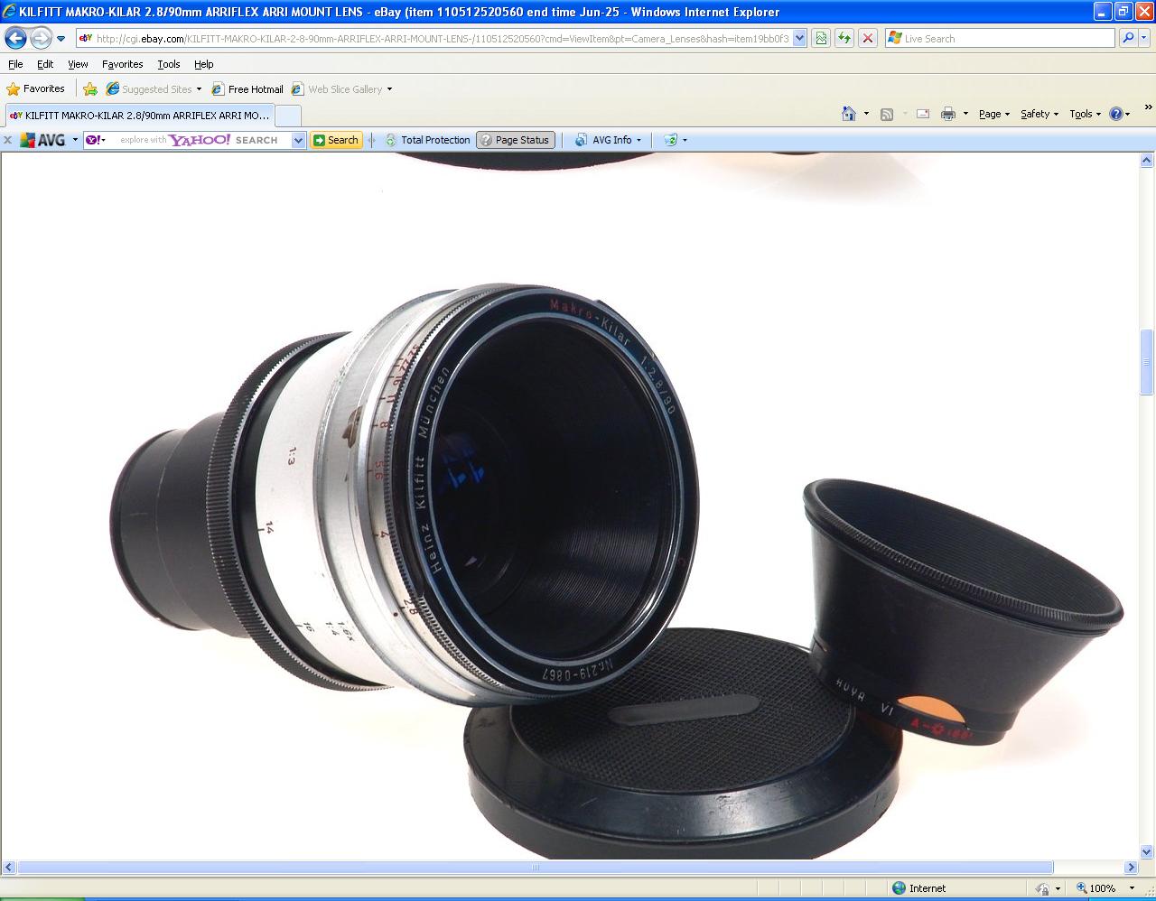

Alex.
Looks like that inner cone is an extra filter holder.

A-ha! Thanks Bob.
