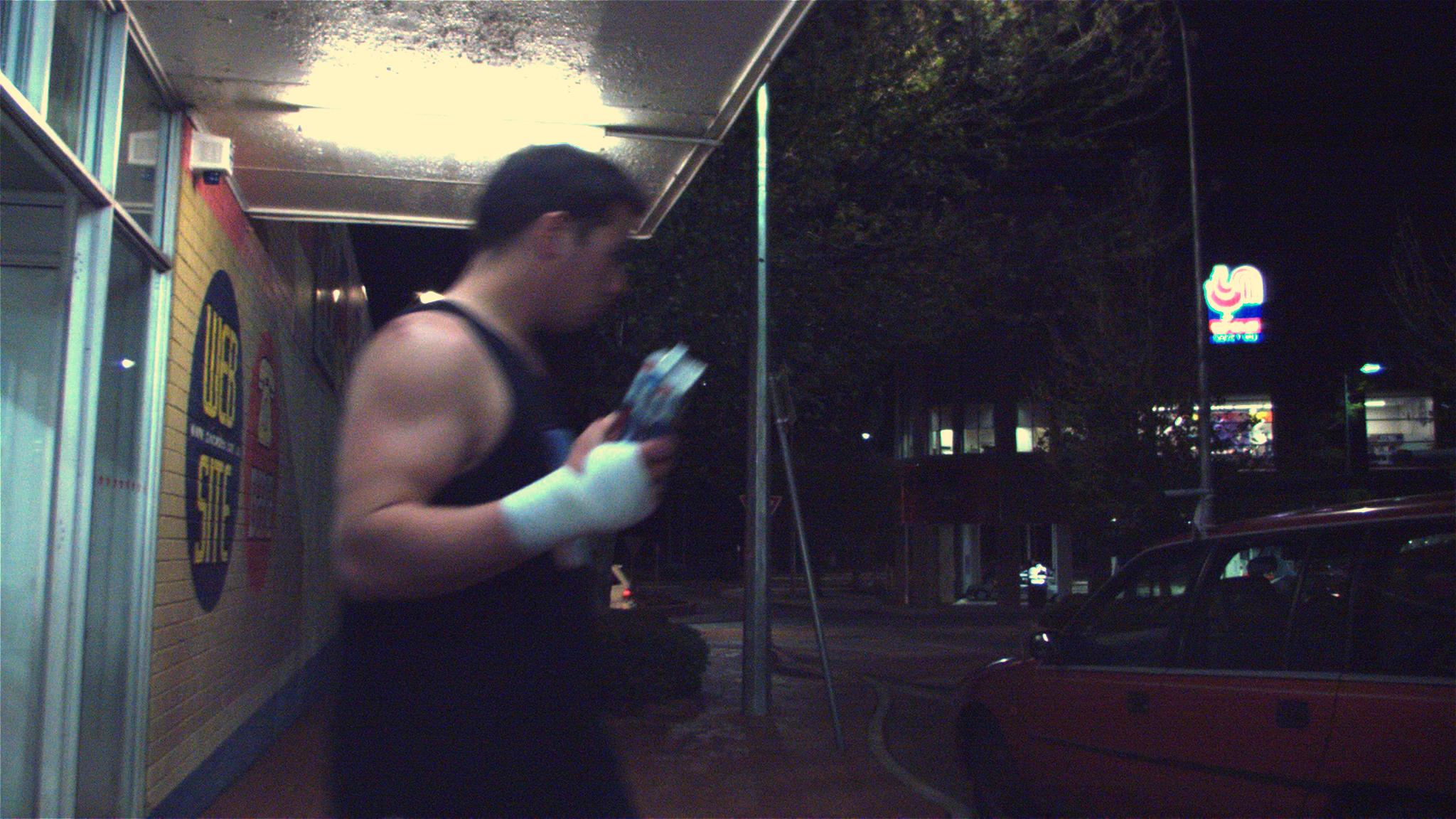

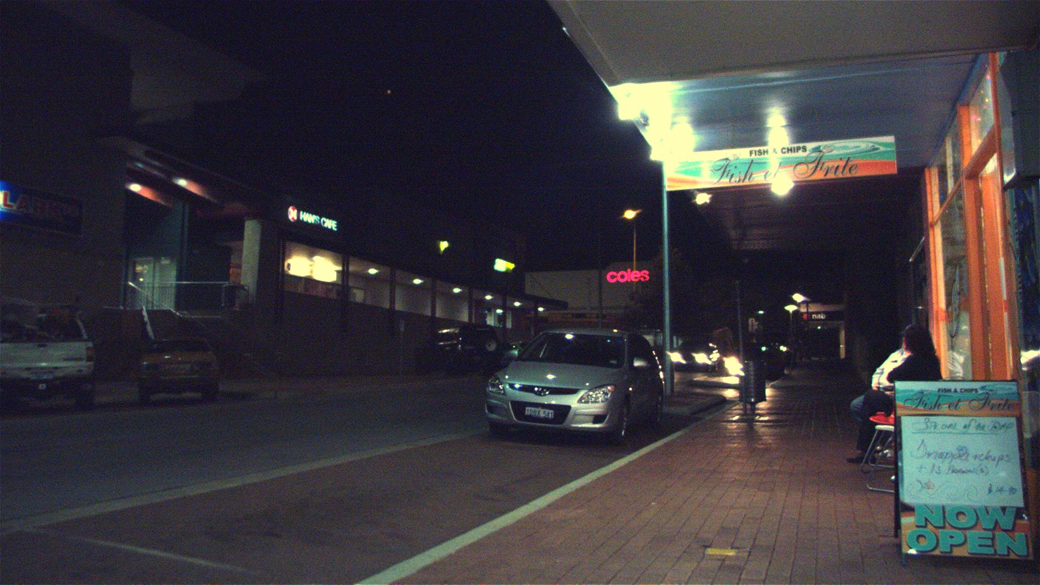

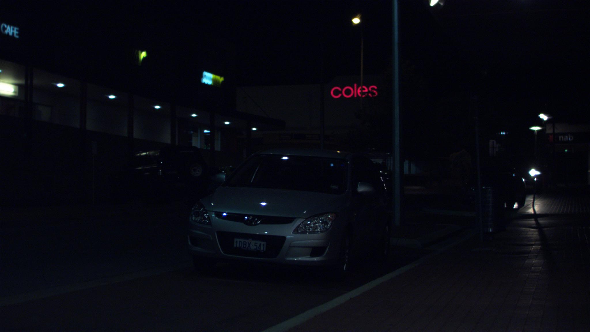

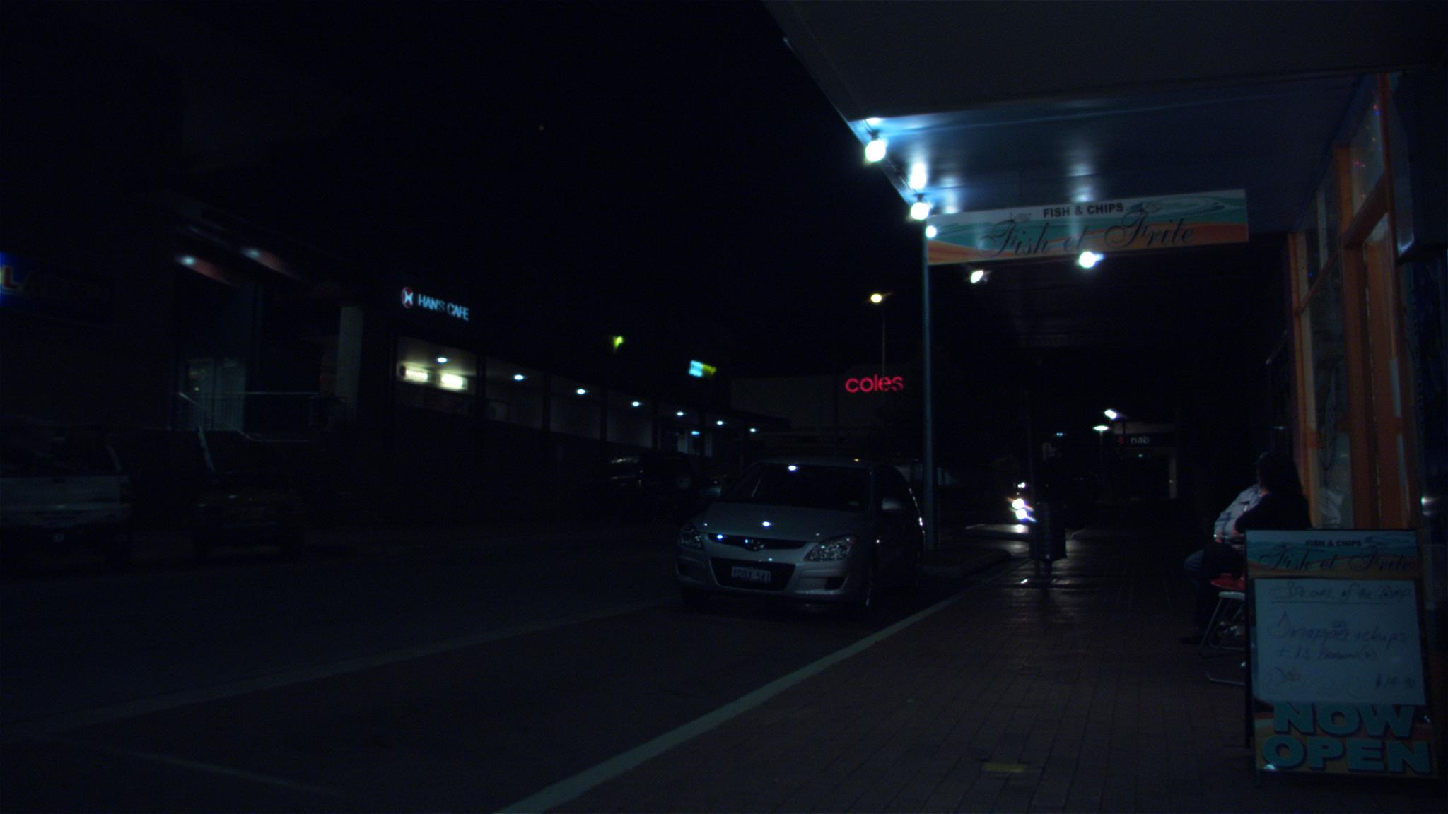

Now the flu is done and dusted and I am only half-dead, I thought I'd get one of the hard bits over first and try the relay in low light in a less well lit corner of the Armadale Retail dragstrip.
The relay was wide-open to provoke any softness it might have. The lenses were Noct-Nikkor 58mm f1.2 and Nikon 28mm f1.4, both backed off into a sweeter spot than wide-open. Camera gain was set to 0db. It is all about not being a fair test. I only shot 0db. I was getting some unwelcome attention from some people in a car across the road out of the shot. So I did not shoot at higher gains but packed up and left. It is a bit of a crimmy neighbourhood. I think they thought I might have been running a speed-camera, something I have been confronted with previously.
Here are a few grabs, two standard, two pushed in post. In the pushed grabs, I dropped the blue channel quite a lot. The camera white-balance was set to 3200K.
Given the hostile conditions, it seems to be resolving quite well.
Researching likely 35mm adaptor use on SI2K.-brevis-lowlight-07.jpg   Researching likely 35mm adaptor use on SI2K.-brevis-lowlight-08.jpg
Researching likely 35mm adaptor use on SI2K.-brevis-lowlight-pushed-03.jpg   Researching likely 35mm adaptor use on SI2K.-brevis-lowlight-pushed-04.jpg
