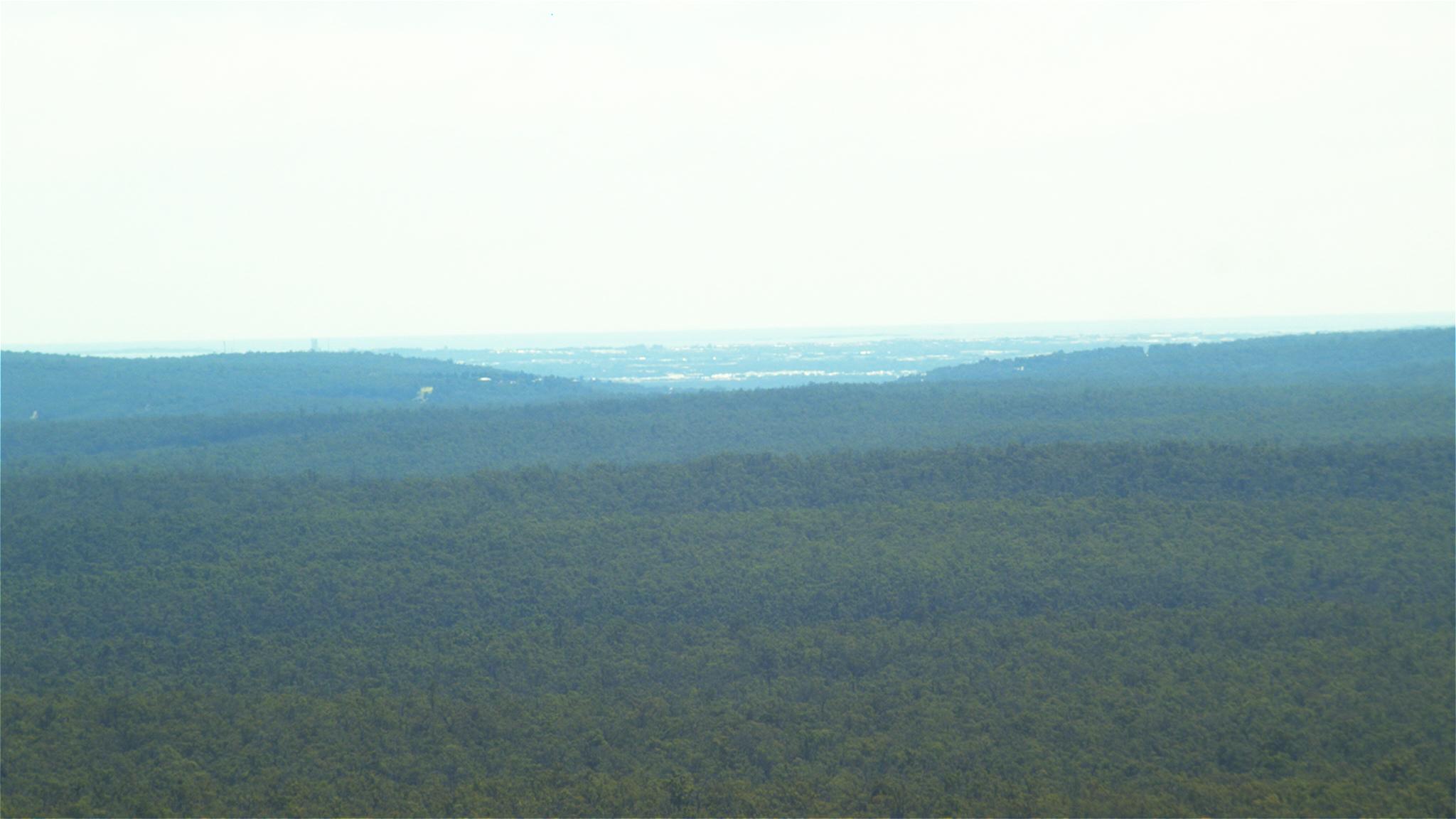

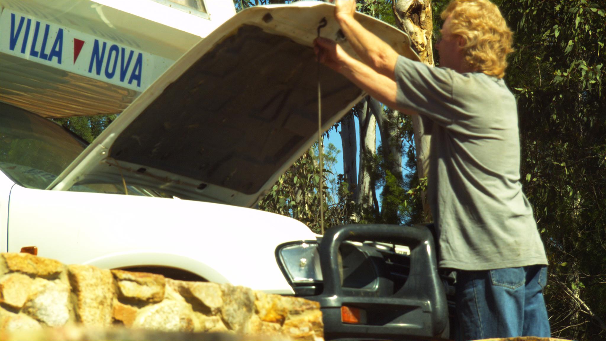

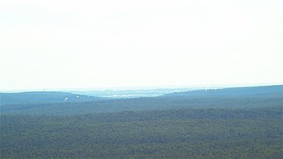

I took the camera out whilst a test was being done on a campervan owned by Western Australian DOP and ecowarrior, Gavan O"Sullivan. He converted his camper to run on filtered canola cooking oil from fish and chip fryers.
The filter was used in association with an ND6 filter. If there is a difference in the image, it is subtle but subjectively to me, greens seem a little more faithful.
However, I am also apparently red-green colour-blind.
Although I don't think so, the aviation doc had other ideas and told me I would be restricted to daylight VFR and only ever hold a restricted licence, = happy flier but no passengers (shortsighted as well), so that fixed my aviation aspiration back in the days of my callow youth.
Anyway, off that subject, here's some happy snaps.
There seems to be a very subtle difference in the colour return from the laterite rock used in the stonewall which was shot with sun behind camera. Laterite typically seems to reproduce yellower than it actually is with the SI2K and the EX1. The blacks on the roo-bar of Gavan's camper seem neutral with or without the Truecut.
The images of the valley were into sun. In these, the Truecut seems to have brought the green in the distant trees to a slightly more faithful colour.

1. ND6 + TRUECUT.
2. ND6 + TRUECUT.
3. ND6.
4. ND6.
5. ND6 + TRUECUT.
6. ND6.
Lens. Angenieux. 17mm - 75mm zoom at approx. T10.5. Whitebalance - Daylight preset.

It is pretty subtle, but the greens do look a little more saturated. I don't see such a marked difference between the greens in 1 and 4 though, although there appears to be a slight exposure difference.

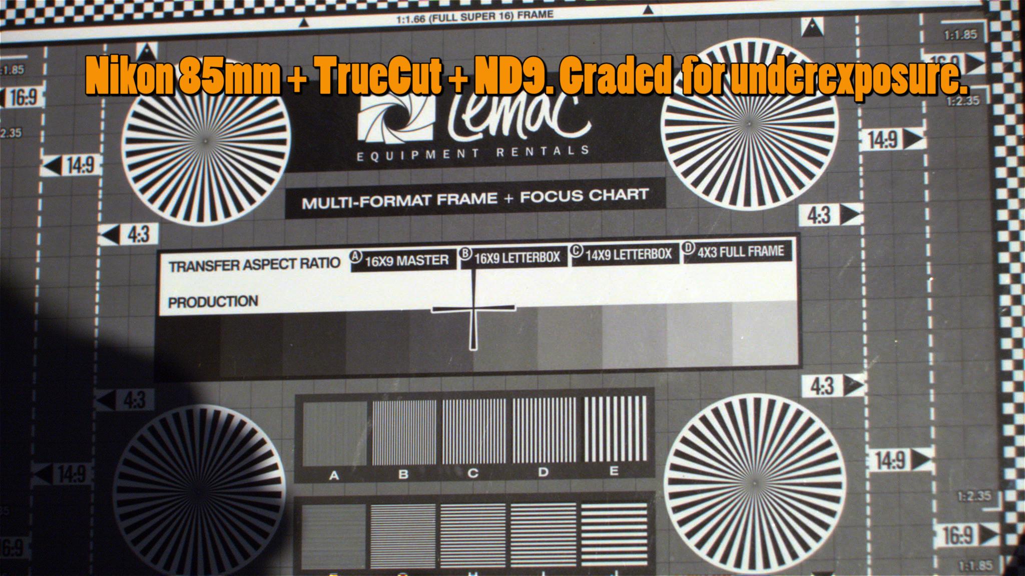

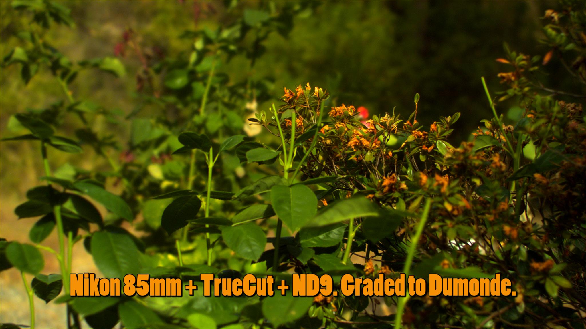

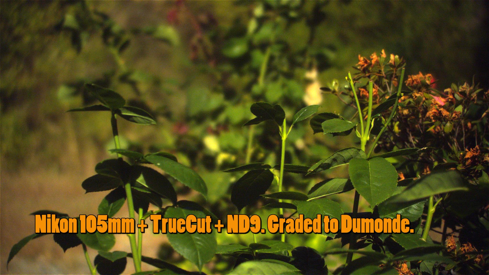

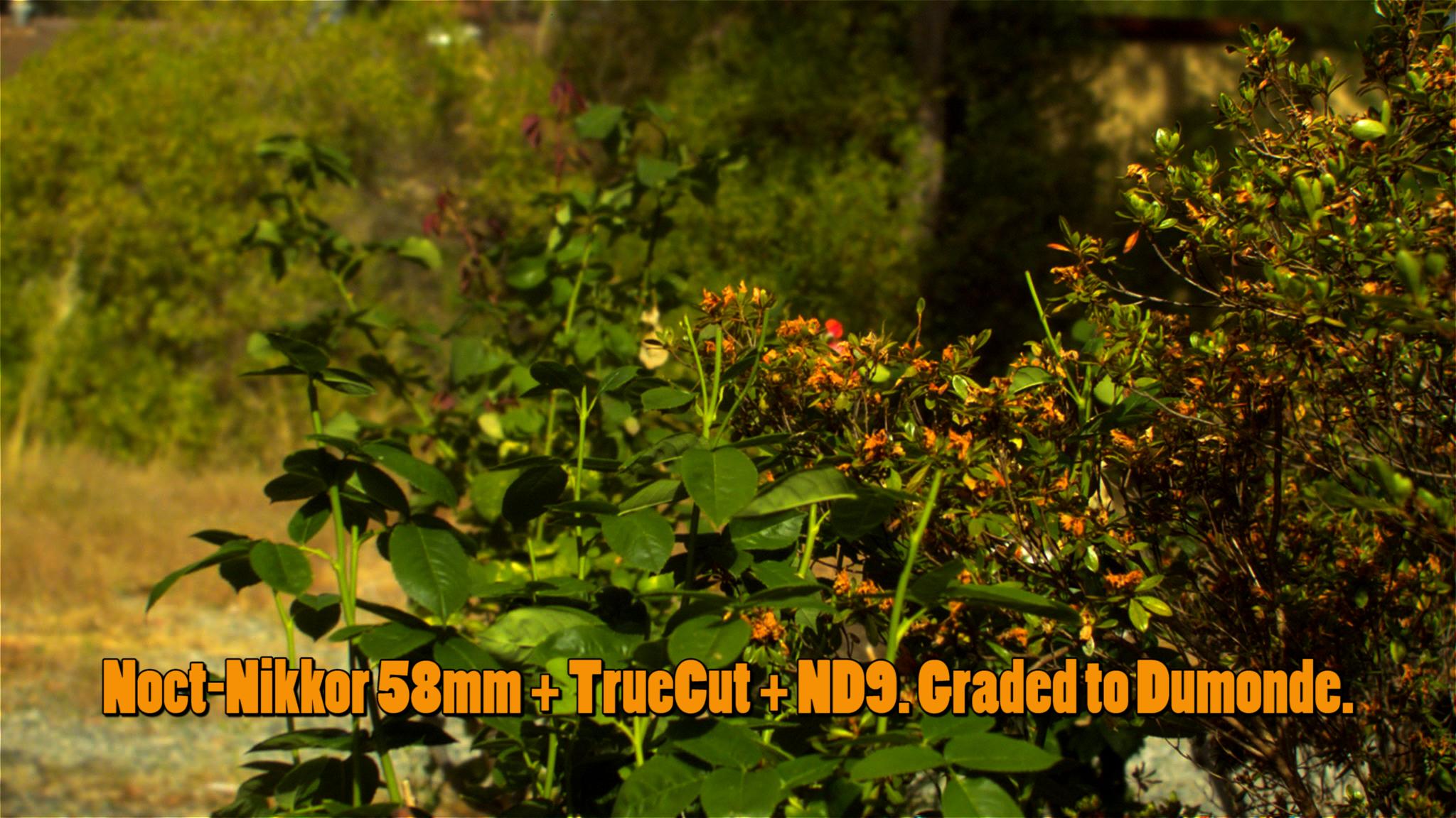

Here are a few grabs from Cinevate varifocal relay - Brevis + Truecut + ND9 filter tests.
All frames have been graded to Chroma Dumonde Chart in same location and lighting conditions which were 4.00pm-4.30pm early summer outdoors facing east, sun behind.
1.2.
3.4.
1. Chart about one stop underexposed, levelled up to "RGB Parade" display.
2. Graded with same corrections applied to restore Dumonde correctly in "RGB Parade" display. Point of focus - Azalea tips near mid upper centre.
3. Graded with same corrections applied to restore Dumonde correctly in "RGB Parade" display. Point of focus - Azalea tips near mid upper centre.
4. Graded with same corrections applied to restore Dumonde correctly in "RGB Parade" display. Point of focus - Rose leaves near right upper quarter.
Lighting conditions for the charts without ND were too bright for apertures to be within acceptable limits for groundglass relay and selective focus.
Camera settings :-
2048 x 1152 @25P.
Gain -3db.
Whitebalance. Daylight Preset.
On "RGB Parade" blue channel was down on the Lemac Chart. Lighting conditions were bright with broken light cloud, outskirts of city smog plume which might explain lower blue level.
Schneider Optics Truecut on SI2K-brevis-truecut-graded-chart-titled-01.jpg   Schneider Optics Truecut on SI2K-brevis-test-upload-2-58-gr.jpg
Schneider Optics Truecut on SI2K-brevis-test-upload-2-85-gr.jpg   Schneider Optics Truecut on SI2K-brevis-test-upload-4-105-gr.jpg
