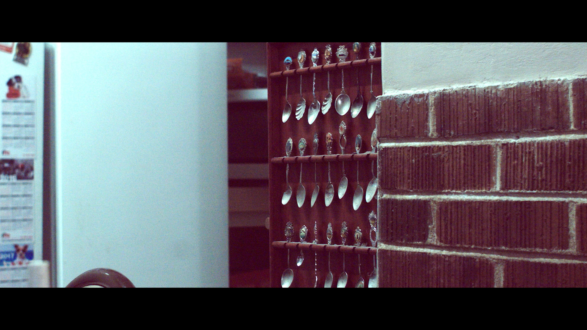

I have been revisiting the uncompressed .siv files. They were an impossibilty with the P+S recorder but it seems that the faux-cinemascope cropped image demands less data. I though there might have been a chance they would work but it seems not so. The buffer indicator does not register when recording a .siv file but the recorder stops and concludes the file at about 1.1Gb.
I managed to get a still image out of it.
The optical path was :-
Nikon 50mm f1.4 lens.
Metabones Speedbooster.
IR filter. ( No OPLF).
Formatt Hitech NC8 filter (behind the IR filter).
This is an attempt to gain a little more sharpness in the image, also trying out a rumoured part of the ARRI Alexa secret sauce which apparently involves a contrast filter close to the sensor.
I acknowledge the generosity of the optical filter manufacturer Formatt Hitech who laser-cut some small NC8 panels for me.
The image was lifted and graded by a BGOBG method as I could not find the "RGB parade" (adobe premiere speak) in DaVinci Resolve which I am trying to learn. As I am partially red/green colourblind it has come out a bit red it seems.

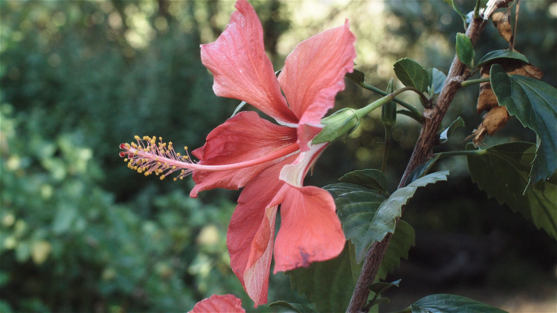

For those who are curious, here is an outdoors image shot with the the following :-
SI2K.
Voigtlander-for-Nikon 40mm f2 lens.
Metabones Speedbooster for BMPCC modified to IMS-Mount.
No OPLF.
IR filter near sensor.
Formatt Hitech NC8 filter panel added close to sensor.
-3db video gain.
Exposed to suit default look. ( Rec709 ).
Shutter 1/100th sec.
ARRI LOG to Rec709 3D LUT added in DaVinci Resolve.
No other grading.
Exported to H264.
Opened in Premiere Pro CS6 and frame exported.
Si2k without anti-aliasing filter.-si2k-no-oplf-plus-nc8-plus-speedbooster.jpg
