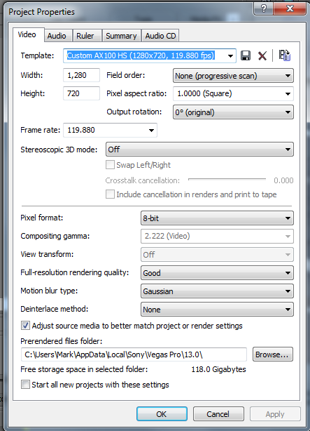

I just did some more checking on the issue in 120fps mode and have found the source of the problem. It wasn't the camera at all, it was simply a setting in Vegas I had over-looked.
Whenever I've dropped a clip on the Vegas timeline, it asks if I want to set the project properties to match the clip. I say yes, and then stretch out the clip so it is playing back at 1/4th speed. Tonight I started messing with the project properties and found that it had been setting the frame rate and resolution to match the clip, but for some reason it set the Deinterlace method to "Blend", even though the clip is progressive. I changed this to "None" and the blurry frame problem disappeared.
This is a great relief for me. The other stuff is a minor nuisance in comparison, I really wanted a poor man's FS700ish slow-mo solution and it looks like this camera is back in the game.
