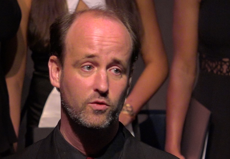

But when I recorded a concert recently, there is a distinct green tint in a certain range of skin tones. See attached (capture from Sony Catalyst Browse, unretouched). I had to correct this in Premiere with Three-way Color Corrector with a Secondary Color Correction mask applied.
Lighting was wonky theater, probably two different gelled 3200k lights, but none green. X70 was on manual, white balance was "A" push-to-set off a grey set piece. Gain was about +9db. 1080p, 35Mbps, xavc.
Thoughts?

In the PP settings, you will find a G-M adjustment under white balance, as well as a R and B adjustment. I find for my gelled LED lighting, that I need a slight +2 magenta shift. Were you shooting under 3200k INCADESCENT lighting? The white balance and color shifts of the X70 are so bad, I recommended NEVER to use push to white for anything other than getting a KELVIN to put into the manual white setting.
The PP's were aligned with 3200k incandescent lighting. I shoot with them using a gelled 3200k LED with a +2 Magenta white balance shift.
Paul

They were tungsten. Probably the push-to-set WB was the issue. Looking back at a previous concert, where I manually set WB K, looks better.

Yeah, most likely the culprit. Any slight "magenta" being emitted by the source light, whether it be reflected, or a gel attribute, would cause a GREEN SHIFT to be added to the X70 if you white balanced off of it. All of the PP's were done on 3200k incandescent. If you want to use them with LED, the recommendation would be to get the kelvin, set manual W/B to that kelvin, then go into the PP white balance menu and shift the green/magenta until you are pleased with the image. The good thing about the W/B PP menu is that there is a PAIR of them. m If you leave the R-B options empty, then you can in effect toggle your W/B shift modifications on and off by switching from LL-BC to R-B.
