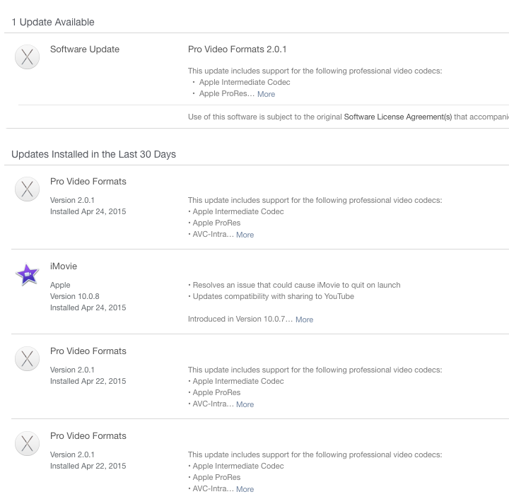

Something is really goofy with Pro Video Formats 2.0.1 update. I keep installing it (via the App Store app) and once even directly by downloading the .pkg file.
But the App Store app continues to show it as an available update. Anyone else seeing this?
Seems like a common problem - this is a workaround courtesy of 'rgilman' over at FCP.co
Here's the workaround:
1) You download the Pro Video Formats package directly from Apple.
2) Open that package in Pacifist and then use Pacifist to install it.
Worked perfectly for me!
Paul Hardy is offline   Reply With Quote
Old April 24th, 2015, 07:47 AM   #72
Join Date: Mar 2015
Location: Chicago, IL USA
Posts: 180
Re: Any word on XAVC-L plugin for FCP X?
Thank you! Fixed my issue as well. I was working with Apple support, but we couldn't get it fixed. This saved me from having to call their Enterprise support (was the next step).
