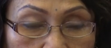

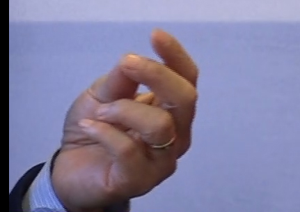

Anyway, I figured this won't be a big deal since it's a CMOS chip it should be a native progressive scan, so I'm thinking a 60i project could be dropped onto a 30p timeline and I can output a progressive file. Done, seems ok. Until I pause motion and see crazy interlace artifacts!! This is present in any player, VLC, WMP etc at any scaling and on my 46" LED TV. It's subtle and you have to look for it, but quite obvious sometimes, and certainly when pausing motion.
I swore that other cameras I used with what I thought was PsF 60i, when placing in a 30p project, without having to de-interlace came out as nice progressive image. I can remove it with deinterlace but with a major hit to image sharpness. I'm using Vegas, maybe I should try another NLE? Is this a Vegas thing, or am I just not understanding how a Psf frame gets 'reassembled' so to speak.
Hopefully below images show up showing artifacts.

That's just because you cannot just drop a 60i clip into a 30p project and hope for the best. You have to deinterlace first, and that will reduce your resolution by about half.
Otherwise, that workflow only works for a 60i clip that has 2:2 pulldown (and you still have to tell the NLE that such is the case), such as how AVCHD records 30p in a 60i container. That's a special scenario that doesn't just happen for clips actually recorded in 60i.

Thanks Gary, I didn't realize it was like a special scenario or 2:2 pulldown etc.
I guess since you can only really notice it by pausing, I'll just stick with the current workflow as the resolution hit is much worse in my opinion. Not like it's mission critical image type work anyway.
Interestingly when dropping shutter to a 30th, the interlace motion artifacts gets lost in the slower shutter effect or whatever and resolution looks pretty much the same. Talking heads have such little motion, may just go that route. Still frustrating that a 2015 camera can't match a 5 year old camera in functions. Price wasn't that much different really. Can't figure why Sony doesn't just make this stuff work with progressive, hopefully a firmware update can solve.
