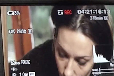

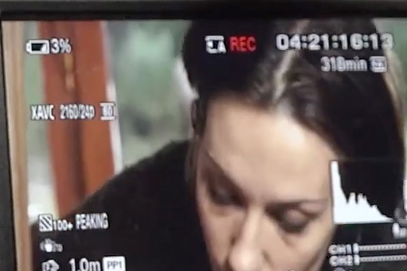

XAVC 2160/24p 60
Yuri Gershberg is offline   Reply With Quote
