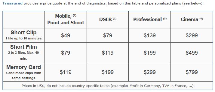

Try these guys. They have some free diagnostic software, Mac, that you can download to look at your files and then it can tell you if they can recover them. They have written their own recovery software. If they don't already have XAVC covered contact them they are really helpful.
aero Quartet: Video Apps and Repair Service
Also read this from their blogs so you can see these guys know their business.
Not a complete failure » Blog Archive » Canon 5D Mk III video files playing only first second of audio and black image
Not a complete failure » Blog Archive » Why Recovered Videos won’t Play
The more clips they have to repair he cheaper it gets. Their pricing schedule is available here:
Movie Repair Service • Pricing
a frame grab of their pricing structure is attached
If you are on PC their technology is available through
MP4repair.org
