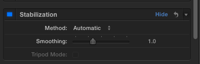

X has a few options, smooth cam and inertia. Inertia is the one that will allow the "tripod mode" check box, if it determines enough of the subject matter is lockable in place, and can be made to look like it was shot on a tripod. Smooth cam is meant to operate more like the in camera stabilization, to add some friction to the motion. Inertia won't really give you jello, but it will be more likely to give you snap changes in framing.

Well! Never noticed those options before. Don’t remember seeing the “Hide” part before.
Hit the down arrow and bingo, there was “Method” and another (up, down) arrow that provided further options (Automatic, InertiaCam, and SmoothCam). In this case “Tripod Mode” is greyed, probably because it decided it wasn’t capable of being stabilized to that degree, or maybe because it had been previously Stabilized.
This particular clip where the screen shots are from had a fair amout of wave action in about half of the clip so perhaps it didn’t know what to do with all that action.
