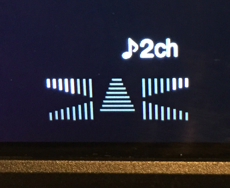

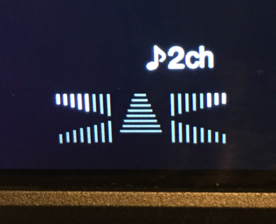

The AX100 is one great little cam; however, and unfortunately, audio doesn’t appear to be it’s strongest point. I’ll give Paul Anderegg some credit on this score (Post #2, score 1 for Paul).
For my cam I’ve been using either the Røde SVM in lieu of the built-in mic or using a (now vintage) JuicedLink CX211 pre that has two XLR inputs. The juicedLink provides some control capability that raises the bar on the audio acquisition side. This particular one was used with my JVC HD7 and that cam had nice VU meters; however, I haven’t found the AX100 meters to be quite as useful. Yet.
Earlier today I duplicated Jeff Harper’s audio test link and my cam acts just as shown in the video, and re-read the British (or EU?) “Help Guide”, section/paragraph 120, “Audio Rec Level”. This, and the video, explains a lot, not only what was happening but also the work-around. Frequently during edit I would cut the beginning of the clip for one reason or other, jiggles from pressing the red button, getting the cam aimed properly, or whatever, so the audio “feature” wasn’t noticed. Now I know.
For the money, though, it’s still a good cam. I was really hoping Sony would come out with an X70 upgrade model so I could use this as the B-roll cam. Instead, it appears they’re just going to do a firmware upgrade on the 70. Canon has been awfully quiet so there may be hope yet.
The controls on Paul’s cam would be nice to have. The whole purpose of a camcorder is to have fast access to controls because video is a moving target.
Last edited by John Nantz; December 2nd, 2015 at 05:38 AM. Reason: forgot to add the VU meter picture
