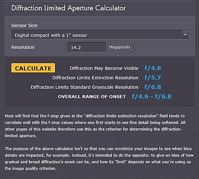

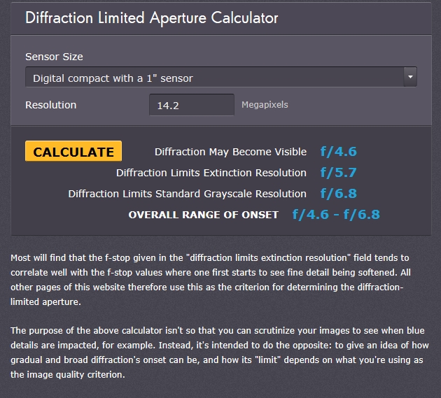

Hi Paul,
There is a nice internet site, which describes all kinds of optical performance limits. They also have a calculator online, where you can enter your camera data and get the answer of your question.
Digital Camera Diffraction – Resolution, Color & Micro-Contrast
Joachim Claus is offline   Reply With Quote

Re: Aperture for maximum sharpness?
Originally Posted by Joachim Claus View Post
Hi Paul,
I am a bit skeptical of that chart, it doesn't jive with what I am seeing, nor the large sensor size. I run 1/3' cameras that are good until diffraction at f5.6. The X70 definitely is sharper and less CA stopped down a stop or two.
