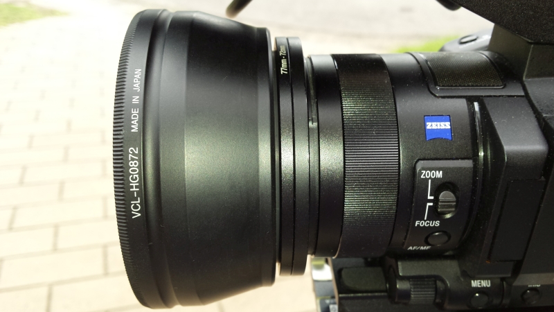

You are thinking of the Sony VCL-HG0872X, note the "X" at the end. That is a different lens to the VCL-HG0872. The earlier VCL-HG0872 from the HVR-Z1 HD Mini-DV cam days is the one that works well on X70s and Z90s with a 62 t0 77mm step-up ring and then a 77 to 72mm step-down ring. You will see why the two rings are required when you see the pictures from the old posts.
Have a look here at the old posts from when Paul and I were digging around for various WA lenses for the X70s. I had one sitting on the shelf from the Z1 days and thought let's have a look to see if we can adapt it. It worked! Still use it quite frequently on the Z90 these days.
Chris Young
https://www.dvinfo.net/forum/sony-4k...-ax100-42.html

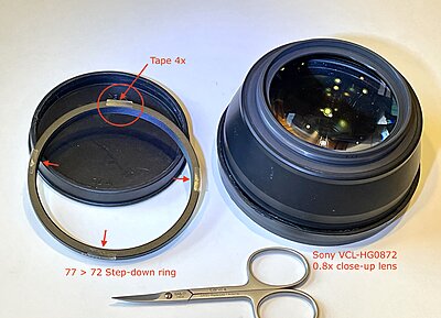

time flys and stuff happens … so, I’m now the proud owner of the 0.8x wide-angle lens. And the step-down ring to attach it. That’s the good news. And, it is good. However .....
Next up: finding a way to make sure the adapter ring does not permanently attach itself to the rear lens threads(!). The adapter rings I’ve been using are brass and have large and easy to grip outer edge. When they are screwed on they come to a somewhat sudden stop such that there is a feeling it will not loosen easily, and, it doesn’t take much to loosen the ring in order to unscrew it and an initial grip-twist is all that is needed.
The new step-down ring operates differently. They are made of aluminum (more on this later) and they screw on easily. No problem there, but it doesn’t have this “somewhat sudden stop” of the brass ring and that puzzles me. The real problem comes with trying to remove the ring. For some reason, even though it is screwed on to a, shall we say, a “soft stop” (knowing full well it won't come off easily), it really takes some effort to “un-stick it” for removal.
So, why is it more difficult to unscrew after it has been lightly screwd on, with all the knowledge it will be difficult to remove? One place I read said that the difference is due to the aluminum vs the brass. This seems weird because both rings have a black coating, thus, there is no direct metal-to-metal contact due to the coating. It is what it is. As an old radio mystery program starts out: “Who knows what evil lurks within the hearts of [a filter ring]”.
The fix-it, or workaround. The “sticky issue” could be caused by different manufacturing specifications, … or not. Can’t solve this. Workarouds include vassaline, grease, oil, graphite, …. and maybe a few more. Plan B is to buy a brass ring and see if it works better, but that cost$.
My short term workaround is to use abut 2mm of generic Scotch tape. As a test, I put four pieces spaced around the SenseiPRO (B&H house brand?) lens ring. When the ring is screwed on it comes to a soft stop, and to remove the ring, it doesn’t take much of an effort to start to unscrew it. Don’t know how well this will last over time, but at least it works for now.
The real fix-it, I think, will be some lens filter ring removal wrenches. Currently thinking of two sets with a size range from 55mm up to 77mm. Rubber-coated metal seems like it woudl be good.
Removal of stuck filter rings can be a pain so any input on any of this is welcome.
I can also visualize a brass ring in my future.
Picture of lens ring with tape. Small scissors with curved tip to cut the tape:

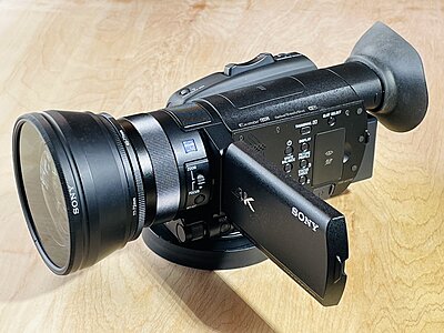

I have an AX53 that I will also use this lens on and it worked very well, and, it may turn out to be the primary beneficiary! There is already a step-up 55 > 62mm ring on it so it can use the filters from the AX700, but with the 62 > 77 and the 77 < 72 rings, there is a slight bit of vignetting when suddenly moving due to the Balanced Optical Steady Shot (BOSS) stabilization system; however, a very small amount of telephoto made the vignetting problem go away. If one went with a 55 > 77 step-up ring, in lieu of the two rings, it is probable that the vignetting would be eliminated.
This wide-angle lens on the AX53 would be a good combination in tight quarters or a crowded situation, such as at a wedding, for example. The large optics wuld not be innocuous, though.
Other than the “sticky” issue with the one ring, there was no problem getting everything screwed together. My technique is to turn the item counter-clockwise until it “clicks” and levels up, then turn clockwise, checking for cross-threading before screwing it on. Everything went very smooth.
It’s a beautiful lens, must feel great to re-purpose a piece of gear like that! And especially on a “non-interchangeable lens” camera!
Thank you for all the work you and Paul did.
Edit: for info, the AX700 is sitting on top of the lens caps
