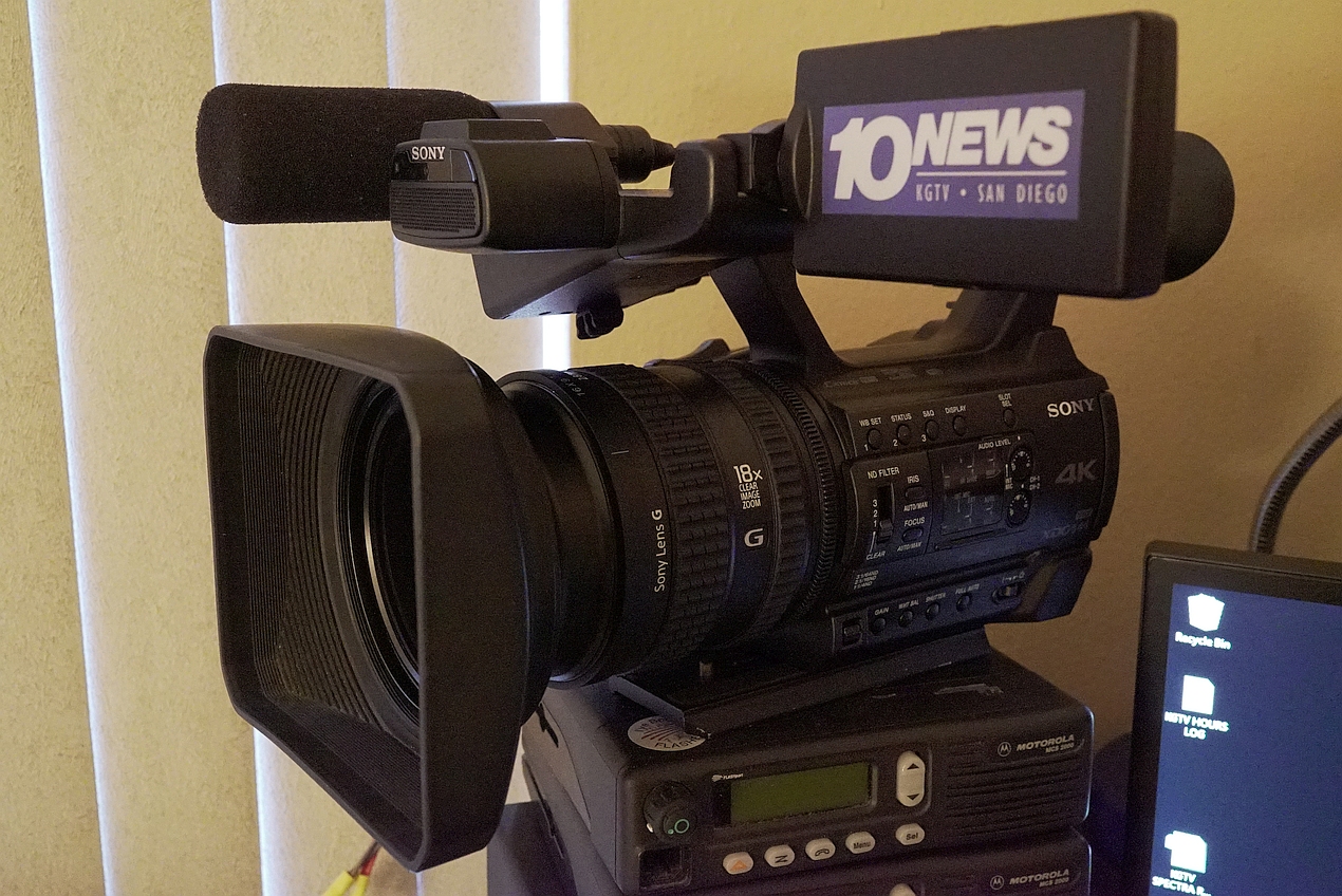

Here is the 16x9 EXII on the Z150, bayonet mounted.
