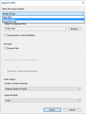

I have ordered the X70 and will use it instead of my Canon XF100 camera. With my Canon XF100 camera i could use Canon XF Utility and select all MXF files and merge them into one file. No transcoding required so itīs lightning fast.
Is there a similar software that can merge together MXF files created by the Sony PXW-X70 camera?
I have tested the latest versions of Sony Content Browser and Sony Catalyst Browse but none of them have the ability to merge MXF files together.

No, what i mean is:
If i for example have 100 hundred 10 second long clips on the memory card i want to merge them together to one (1) clip so it is easy to scrub through all the clips in the NLE. I used to capture the whole tape when i used tape cameras, so having one hour video in one clip was for me more convenient than having each clip as a separate clip.
I was aware of the great fact that long takes now ends up as one clip. :)
I used the "Provide Feedback" in Sony Catalyst Browse yesterday and gave them my wish and did send them screen dumps of Canon XF Utility.
/Roger

Letīs say that i film four things during a day, four things that have no relation to each other. Letīs call them 1, 2, 3 and 4 for this example.
With my Canon camera i bring in all clips into XF Utility and sort the clips so all clips filmed at 1 becomes one clip. All clips filmed on 2 becomes one clip. All clips filmed on 3 becomes one clip. All clips filmed on 4 becomes one clip. This needs to be done one time only.
So now i have four clips and if i load the clip with all events from 1 i can easily scrub the footage and set markers to mark up good takes, good audio, etc.
I can do the same things if i sort the clips in the project but i prefer to do that before i bring the footage into the NLE since if i do it before i only need to sort it once. There are ways around this but i prefer to work with one large file than 100 smaller files with the same content. Somebody prefer Windows, somebody prefers Mac. Same same but different.
