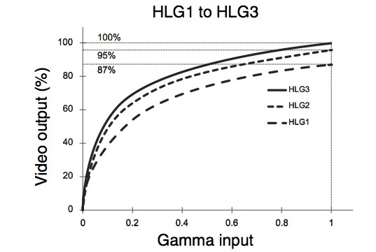

The thing with Sony's HLG, ‘Instant HDR’, is that the metadata embedded in the XAVC video file when recording can be read by a supporting TV or monitor and displayed automatically with the correct HDR settings. Hybrid Log-Gamma was specifically developed for broadcast television by the BBC and Japanese broadcaster NHK. The main benefit is that HLG’s native compatibility allows existing broadcast SDR infrastructure to be re-used for 2020, 2024 and 2100 HDR transmission. The HDR encoding will automatically be displayed correctly as HDR when viewed on a TV or monitor that recognizes the HDR 2020, 2024, 2100 sub code data switch. If the TV or monitor cannot see and decode the HDR sub code data switch then the stream will only be displayed as HDR 709.
In other words if you have the color mode on your recording selected as 2020 only HDR display equipment OR NLE software that recognizes the HDR 2020 switch will correctly interpret your footage. If it is recognized as HDR the NLE software would then have to be operating though a graphics chain, e.g. graphics card and monitor that supports HDR to display it as HDR. If the hardware and software don't see the HDR switch then all that will be decoded and displayed from the 2020 recording will be the embedded 709 color space information.
HLG1, HLG2, and HLG3 all use the same gamma curve characteristic. Only the dynamic range and noise suppression characteristics differ. Regardless of whether the 2020 or 709 color mode is selected for the recording the maximum values for the recordings are the same as for SDR as this HDR workflow was designed to be run over SDR transmission systems and infrastructure. HLG1 peak is 87%, HLG2 peak is 95% and HLG3's peak is 100%. Sony's HLG2 being the best optimization between signal dynamic range and the noise floor.
Of course if the recording was color space 2020 then imbedded in that 87% to 100% range is the extra highlight information that will be extracted and displayed by hardware and software that recognizes this HDR sub code data switch and is capable of displaying the extended highlight range.
Paul I would suggest that FCPX doesn't yet have the code to recognize the HDR sub code switch and is only seeing the embedded HDR 709 information. i would think that is why it is flagging you a warning when you try to switch FCPX to 2020 color space.
Well that's how I understand this minefield of HDR as it stands. I may be wrong but I don't think so.
Chris Young
CYV Productions
Sydney
