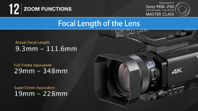

Here's a page from my upcoming Z90 training video. The AX100, NX80, AX700, and Z150 all use lenses with the same specifications.
http://www.dvinfo.net/forum/images/attach/png.gif
Sony AX100: 9,3 - 111,6 mm lens. Focal length (equivalent to 35 mm)?-z90-lens.png

If I"m guessing right you want to know how the ax100 focal length translates to the focal length of your gh5 lenses?
Like Doug has shown and what also is available on the spec list link you provided show that the ax100 has a f=29.0-348.0 mm (16:9) 35mm equivalent focal length.
If you want to know how that translates to your gh5 you need to divide those numbers by 2 so to cover the same focal length as the ax100 has on your gh5 you need a lens that can go from 14,5mm to 174mm. The only lens that I know of that comes close to this is the 14-140mm from panasonic, if you then would use the ETC mode from the GH5 you could about get the same reach, depending ofcourse if you shoot HD or 4K.
