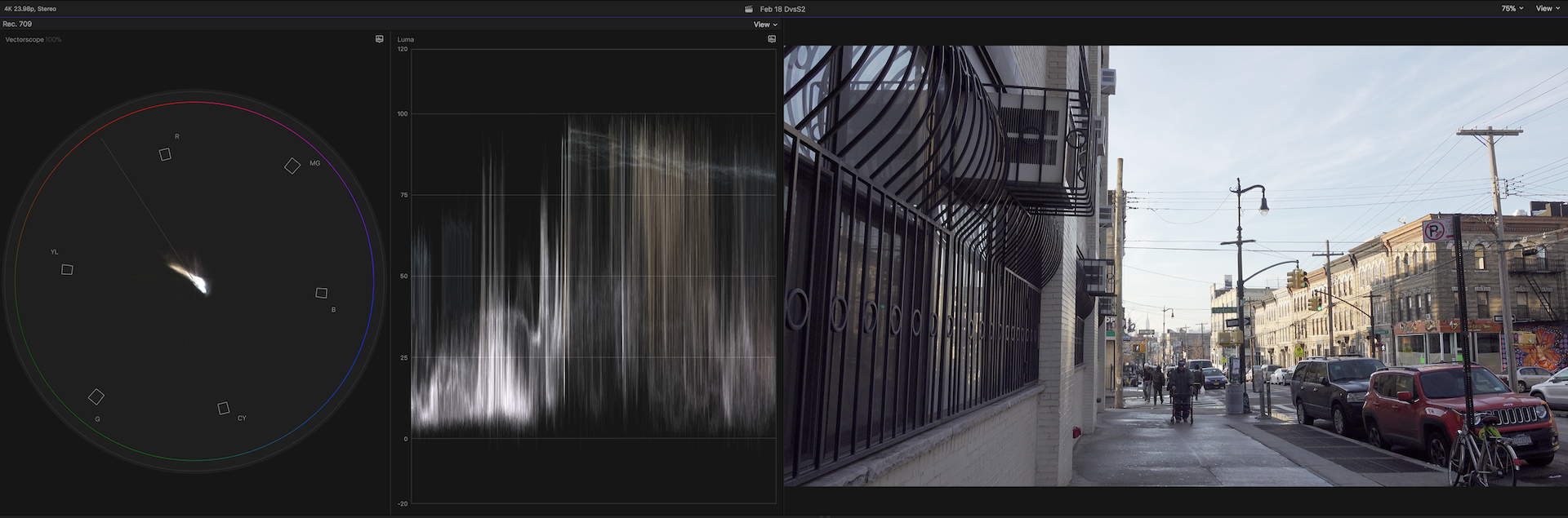

First is based on Doug Jensen's recommended profile except I left Detail at 0 and brought down highlights in post.

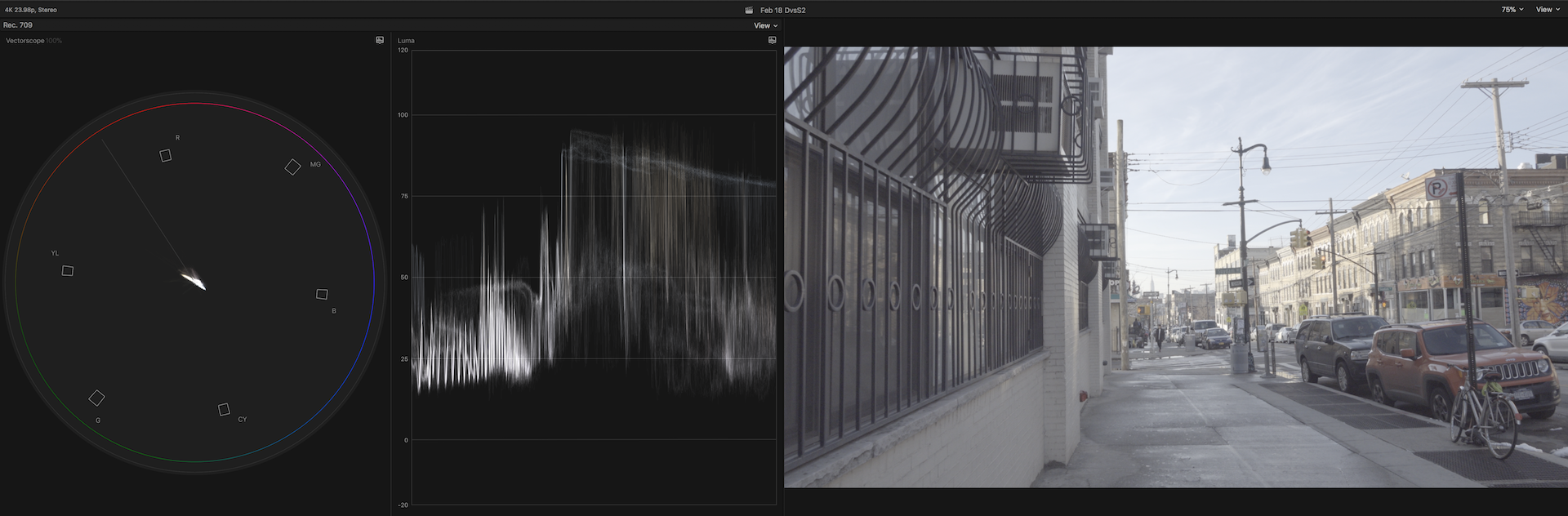

Second (on the right) is S-Log2 S-Gamut which is PP7 on the Z90.

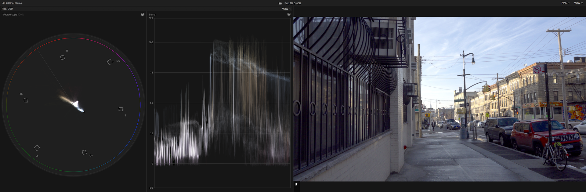

Third (on the bottom) is the above with Coremelt Chromatic plugin with exposure adjusted then S-Log3 S-Gamut3.Cine applied and then further graded. Obviously grading includes a subjective aesthetic and of course one can also grade non S-Log profiles as well. I noticed it was softer than my variant of Doug's and, when looking at PP7, it seems Detail is at -7 so this is one reason why I'm experimenting. I'll change that to 0 and to another test at some point.
I also included the scopes so you can see some of the technical differences, especially about what you're starting with compared the non S-Log picture.

I do like the third (graded SLog-3). Definitely more saturated, and perhaps that is thowing me a bit off when looking just at tones. But I think it looks good.

DITTO! Sky is good.

But is the sky what's most important to the shot? Is it the subject?
Just the beginning test to see what would work. If it were the red car and the mural of the right, they would be problematic as they may be underexposed and over saturated but that may just be part of incomplete grad. I'd have to see if that can be improved. If genuinely underexposed in an 8 bit 4:2:0 codec shot in S-Log2 it could be irreparable. I shot this because I knew it would present a number of challenges with some potential worse case scenarios. Had the scene involved someone exited the car the exposure would likely had to have been higher.
