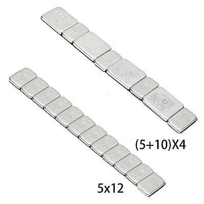

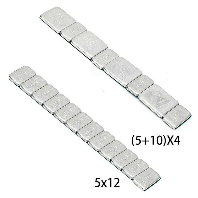

I've never removed the lens hood and have not had problems balancing. It would be nice if there was a bit more weight towards the back like being able to use a bigger 100 series battery but that then causes a clearance problem. If extra rear weight is needed use adhesive car wheel balance weights stuck to your battery or the underside of the sled plate. Left stuck on the bottom of a battery they are not really a hindrance in general off gimbal use. Cheap and available at most auto stores or off eBay.
