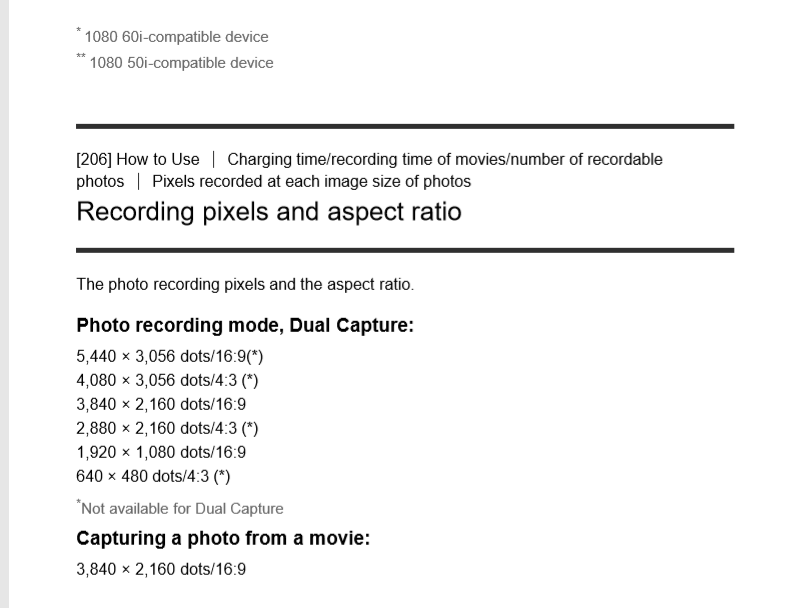

The sensor has 16 megapixels. Photo resolution can be changed in the settings, up to 5,440 x 3,056 (16,624,640) pixels.
