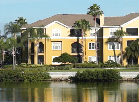

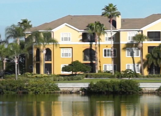

The new camera is just as bad as the old one, not sure what's happening, but I just can't get it to resolve any detail. Hopefully the attachments work. The image labeled "a99 outside 1 photo" is a still from the scene, everything else is just a series of exported frames with detail crops from the middle.

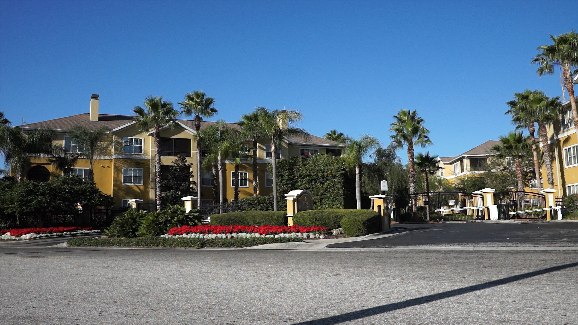

More images. Again "A99 outside 3 photo" is a still to demonstrate focus, the rest are frames from the actual video. This one and the previous post were shot at f8, about 30mm and base iso of 100 for the a99 and 200 for the em5.

Lastly an indoor shot at a moderate high iso - 1600, again at f8, just to see what happens with the iso bumps up a bit. FYI, on all the sequences steadyshot and the EM5's IBIS is turned off, exposure was full manual outside of WB (forgot, doh!) and I used focus magnify in stills mode to get critical focus. The A99 footage sharpens up a bit and the better DR compared to the EM5 is visible, but compared to one another the A99 is just mush. Shallow DOF shots look great, but wide shots just lack detail. It looks o-k on a computer monitor, but who doesn;t want to show off a fancy HD camera on their 42" HDTV. I know I do and when I watch the video, the A99 looks real bad on a moderately "big" screen.

Unfortunately, because the A99 and the VG900 share the same sensor, this isn't surprising at all, the VG900 footage is complete junk. The A99 video quality has been panned by every review I've read, even non-pro ones. I understand your disappointment, because on paper the A99 is really impressive and has a lot of nice features for video. But until Sony can sort out the (video) IQ, it's going to be a pass for most pro video people - couple that with the limited alpha glass and difficult to adapt mount and it's not probably going to end up in any quality video productions.
