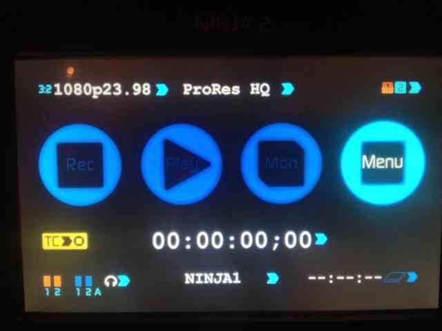

Hey I want to make sure I don't give the wrong answer so I've attached a photo of the screen

Looks like the remaining recording time is blank. Do you have a drive with available space in the ninja?

You nailed it Matt!
I'm so new to any technology that's come out since the last time I made a major investment in video that these external recorders were alien to me. Either there wasn't anything in the manual or I failed to see where you're supposed to format the disk. To answer your question Chris I did contact Atomos, and a rep did send a reply asking a couple of questions. I replied back answering the questions and also asking if I needed to format anything--if that's why it wasn't working. Never heard back after that. Nada. Looks like Atomos is going to try to out-Sony Sony in customer service.
Bottom line, as soon as I got back from Thanksgiving, I took Matt's suggestion and pressed the hard drive space remaining button and that lead me to a formatting option and voila--it works!
