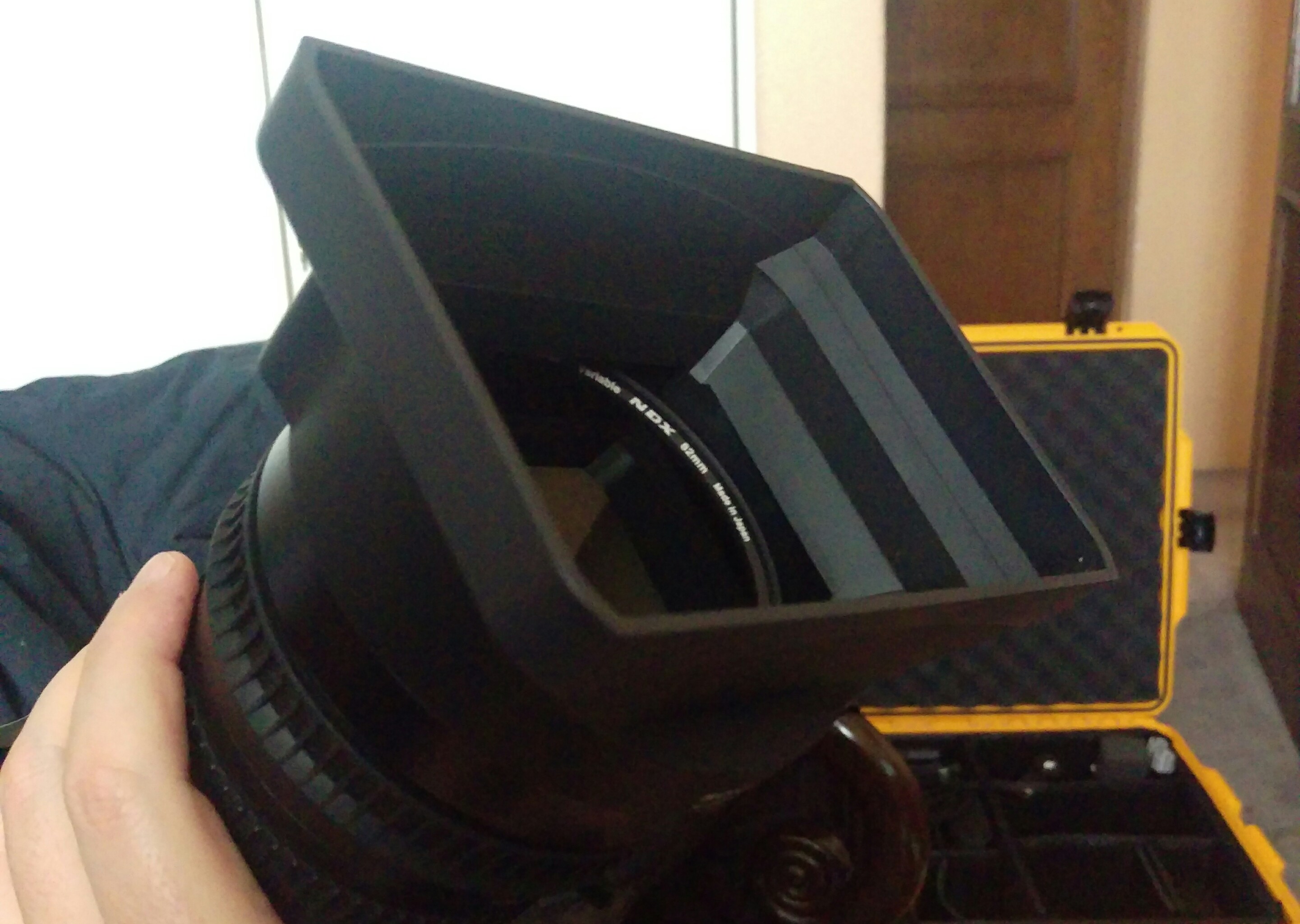

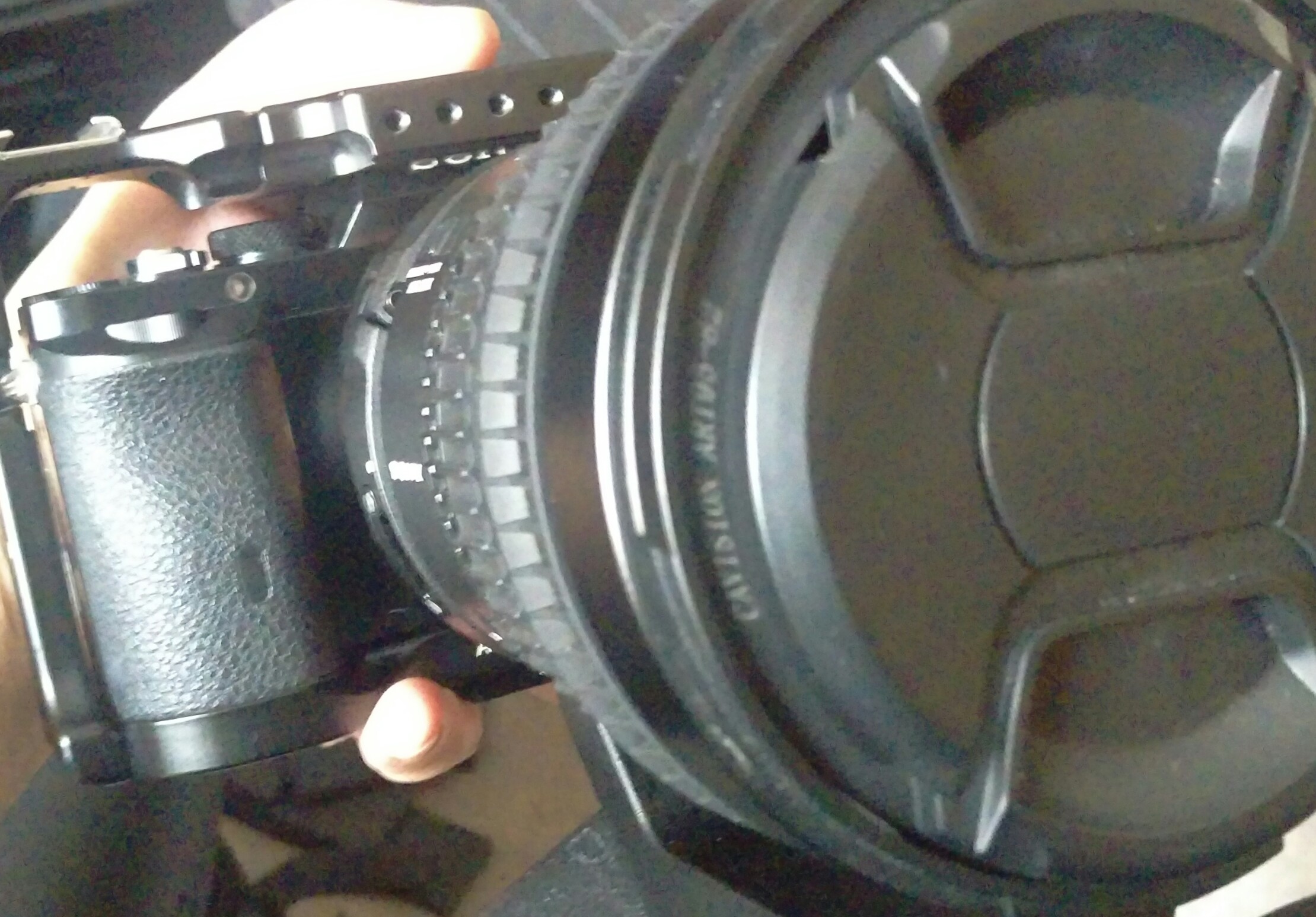

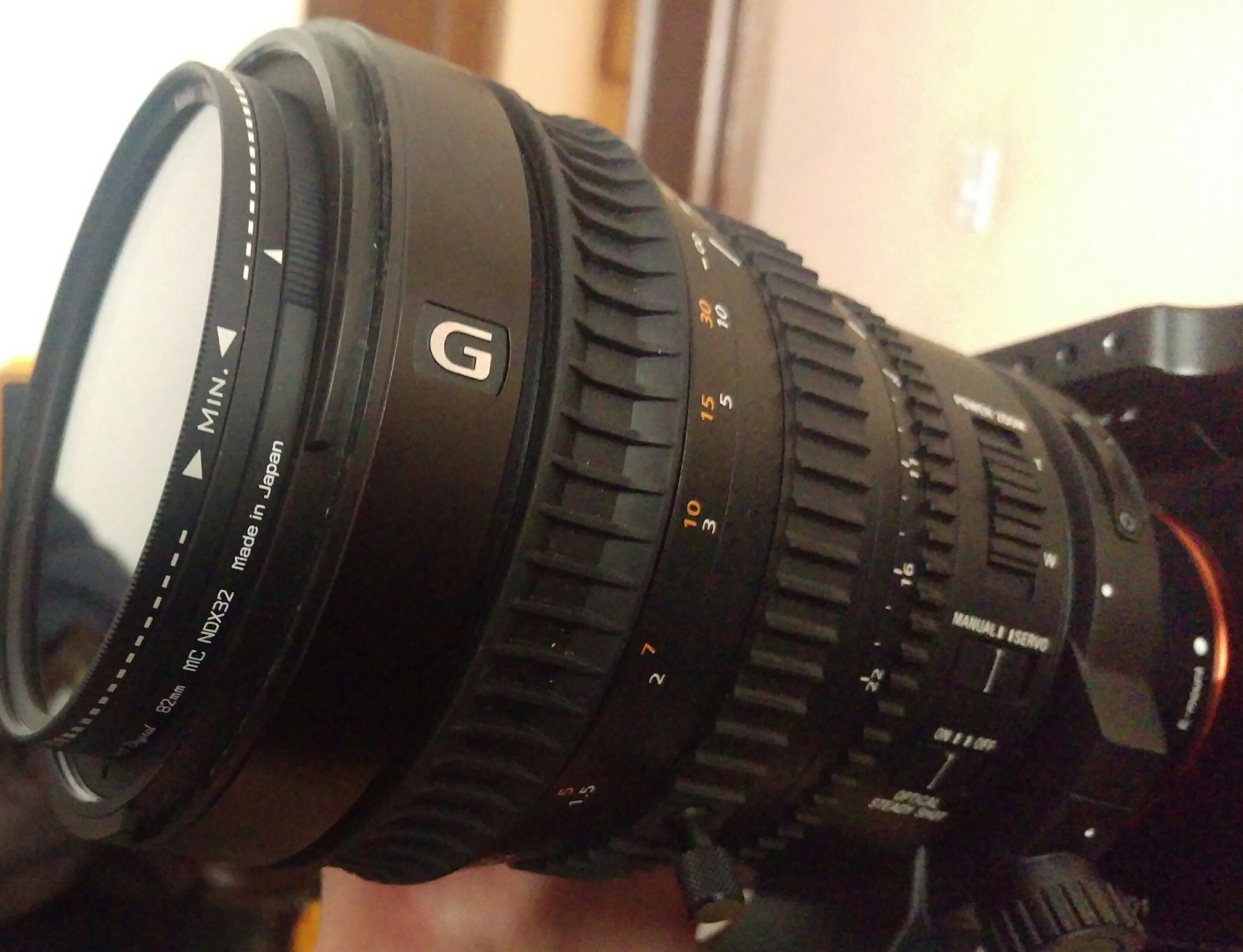

Nope. With 2 thick filters you get a very small hint at the edges at 28mm in 4:3 photos. In video mode you can go 3 filters deep. (Why would you though?)
You can even reattach the lens hood with filters. I just leave the step down ring on all the time with a 82mm pinch cap.
I've uploaded some pictures for you to look at.

Thanks for the advice Luis, this looks like a great solution. How have you found the kenko's ndx variable nd filter?
