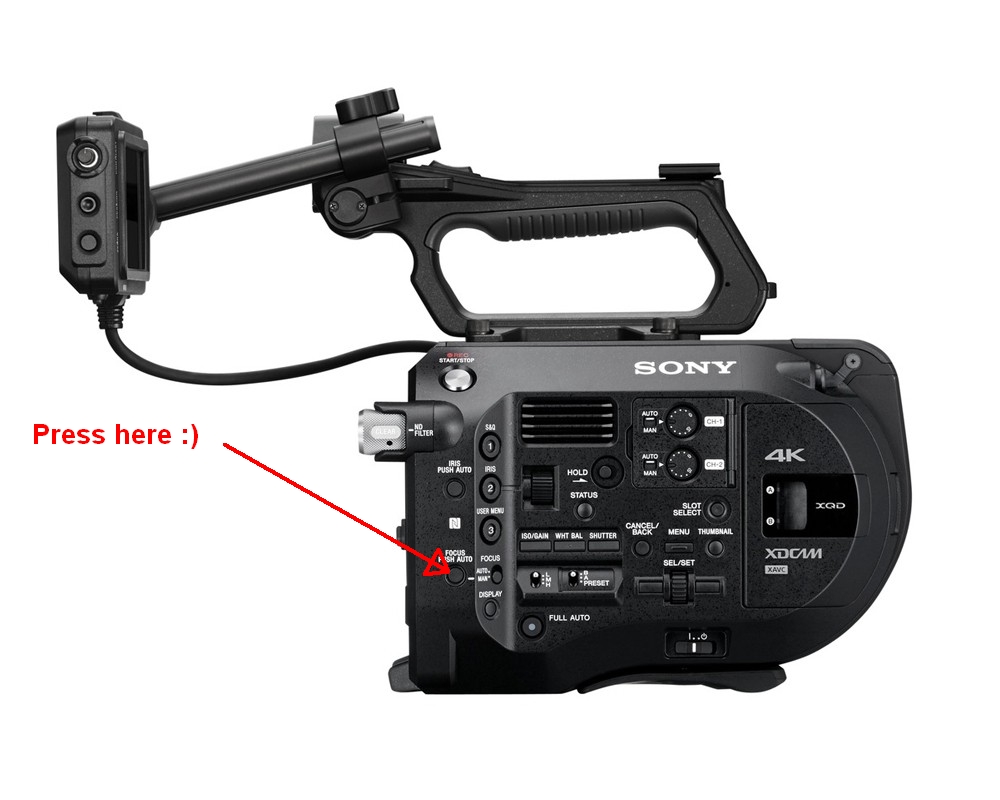

Forgot to ask-Where is the "momentary focus " button?
I don't use the handle
Bruce
Bruce S. Yarock is offline   Reply With Quote
Old November 9th, 2017, 12:43 AM   #5
Location: Sydney Australia
Posts: 1,622
Re: New sony selp18105g autofocus question
Hi
If you don't have the handle on the camera you use the button down on the left hand side adjacent to where the 'auto / manual' focus selector switch is. It's just in front of that on the side.
