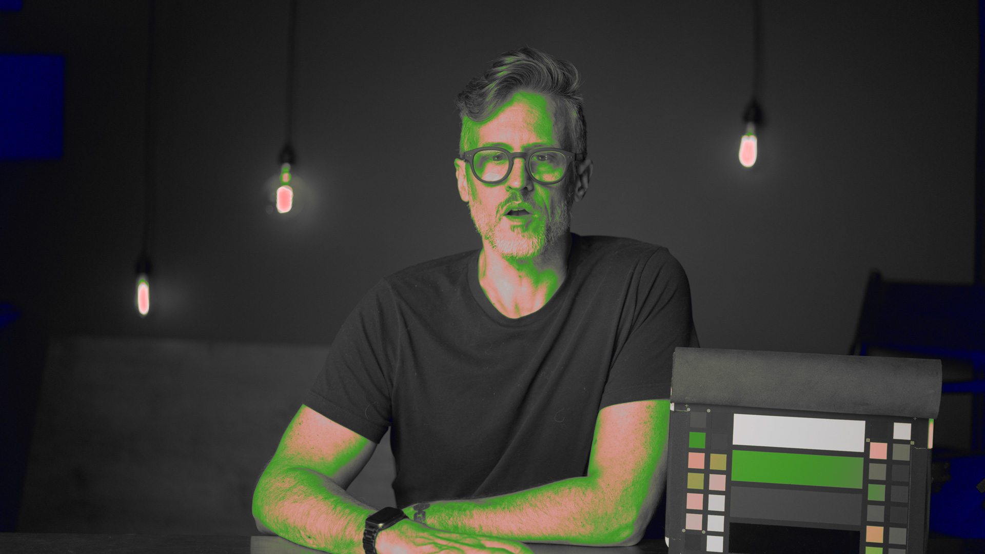

I'd like to share a false color LUT I made for monitoring SLOG3 while shooting.
My goal with this LUT is to display a properly transformed REC709 image that is both good for judging exposure AND pulling focus.
My problems with most other false color LUTs are:
1. They're designed for a REC709 image, so if you're shooting SLOG3, they're off.
2. The false color is overwhelming. Assigning every value to a color makes the image a confusing rainbow.
With this LUT, I only color a few key ranges:
Middle grey = green
Caucasian skin = peach
Nearly crushed shadows = blue
Nearly blown highlights = red
Because the majority of the image is a B&W image with proper contrast, I can keep the LUT up even while puling focus.
Posting link to the LUT here in case someone else might find it useful: https://drive.google.com/open?id=19T...m&usp=drive_fs

The LUT starts with the proper technical transform for SLOG3 to REC709, so these values are POST color space transform:
Blue below 10
Green between 45 - 55
Peach between 55 - 75
Red above 90
The color coding is a smooth ramp, not a hard cut like most false color systems.
I expose for "non-whites" the same way I expose for everything...to taste. ;-) I wouldn't put always put AA skin in a certain range any more than I would always put caucasian skin in a certain place.
This is just a tool to help visualize the exposure range and ensure the scene is landing where you want, it's not proscriptive of where it should be.

Here's a grab for reference.
