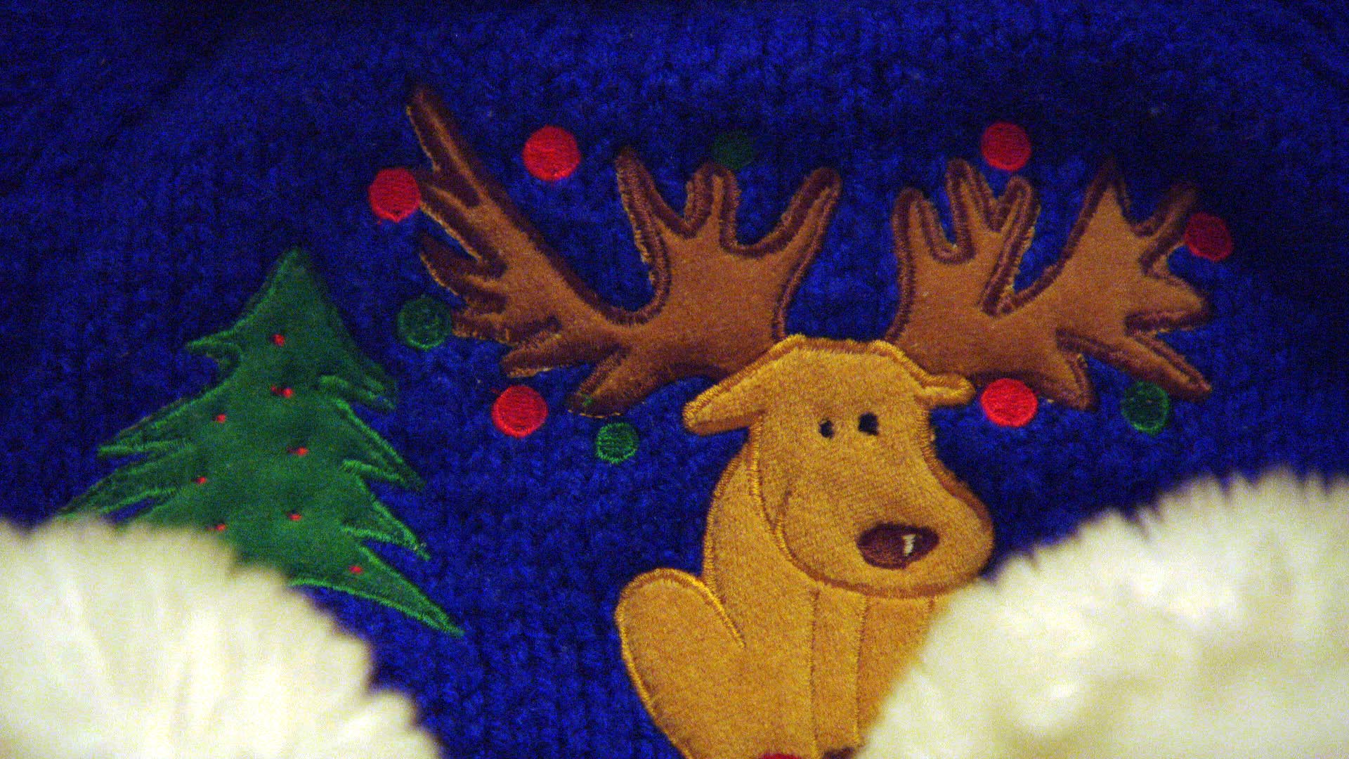

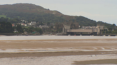

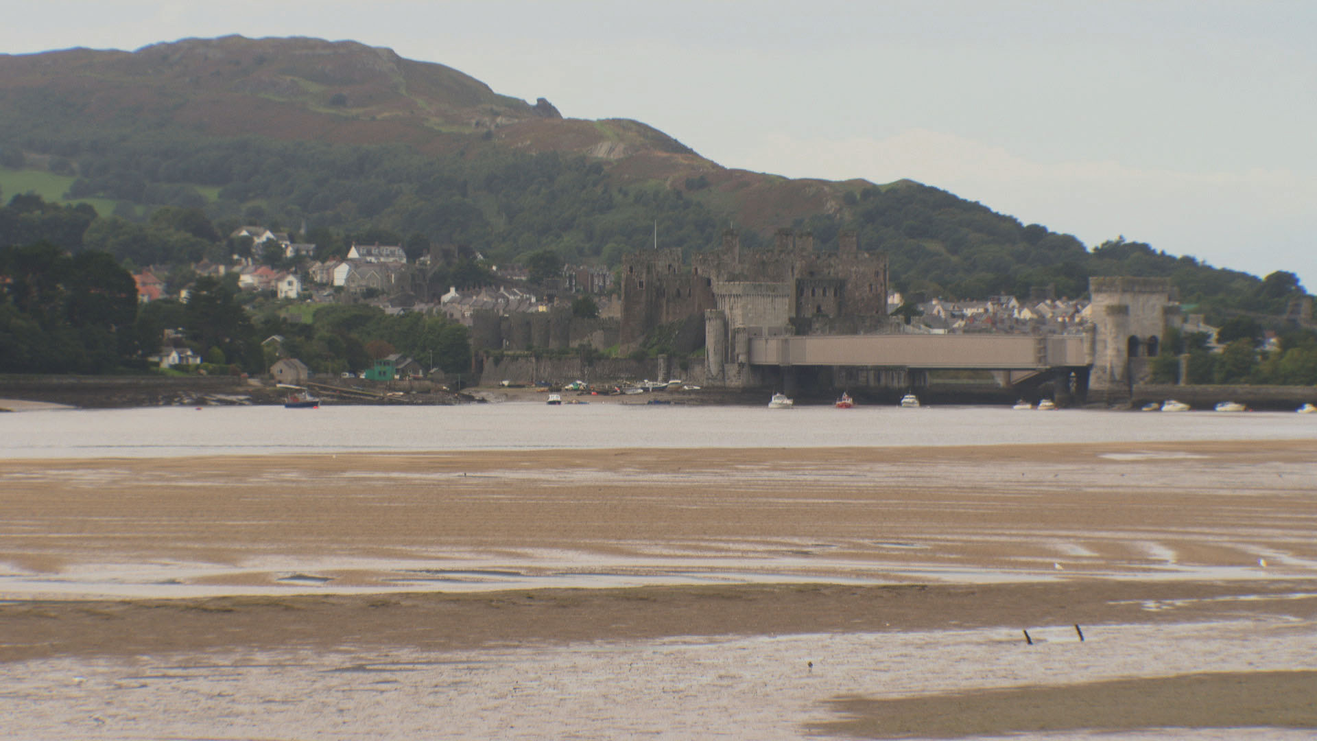

Here are 2 frame grabs from PDW700, one with old Canon J14x8.5 the other with Canon HJ22x7.6. Light's crappy (just done it 5 mins ago, will do more soon). Both wide open, 0db gain. Which do you prefer?
Steve

Old September 11th, 2008, 03:05 PM   #7
Location: Malvern UK
Posts: 1,931
At a glance I'm damned if I can tell the difference. Might be worth doing a landscape shot though, then the differences might show.

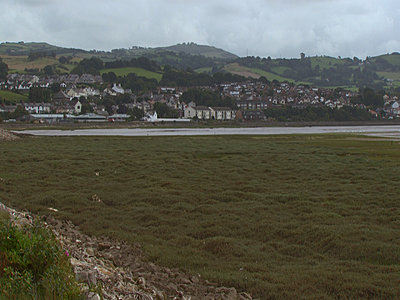

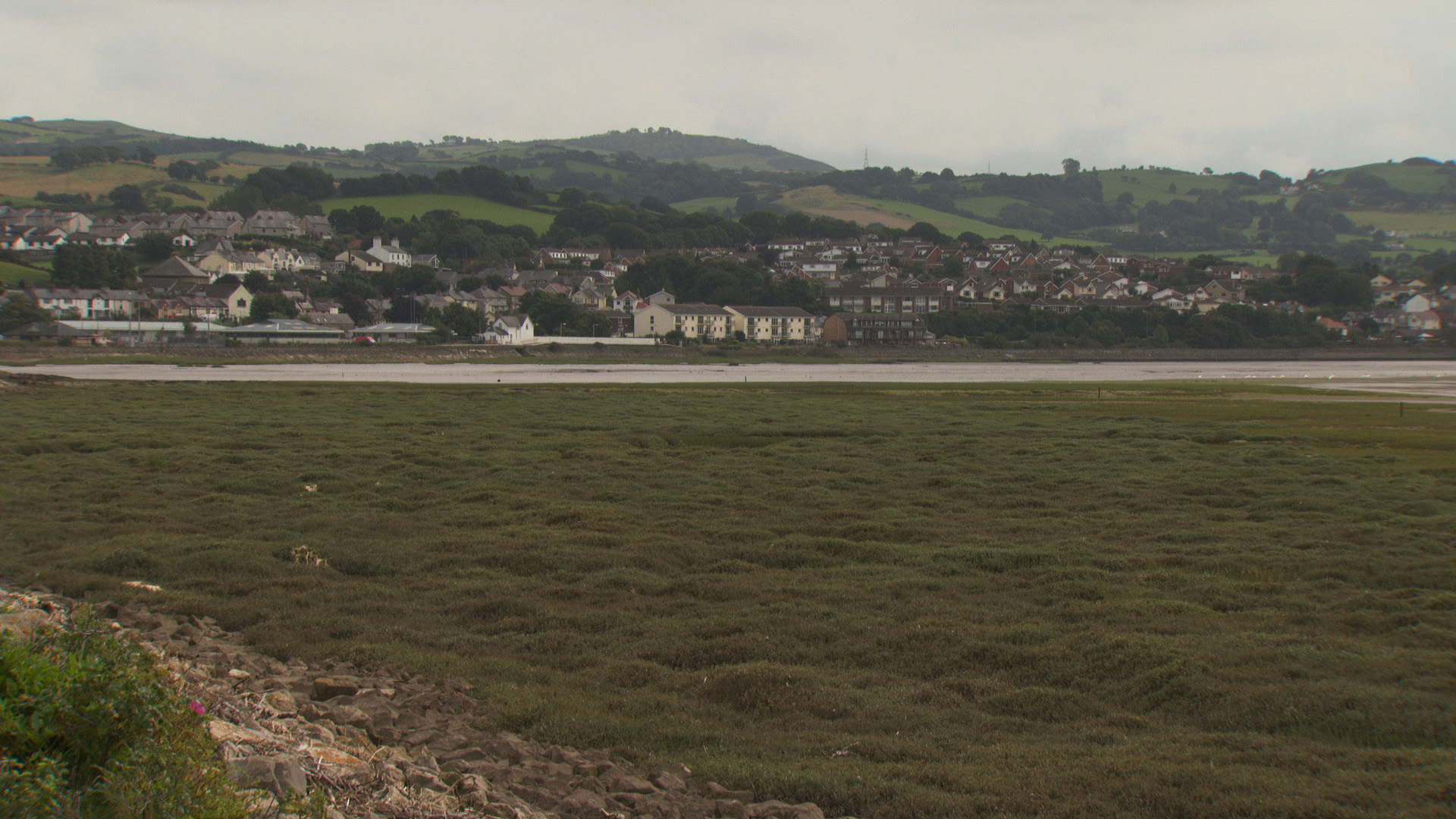

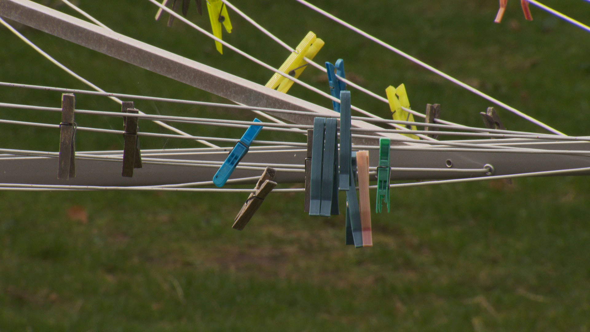

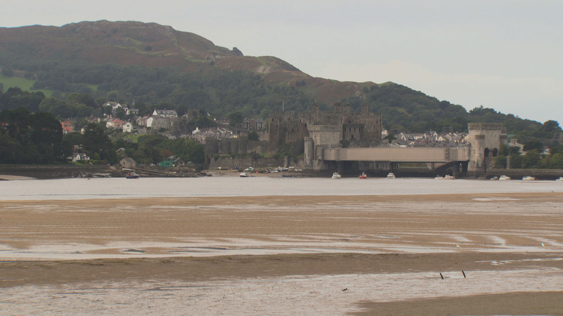

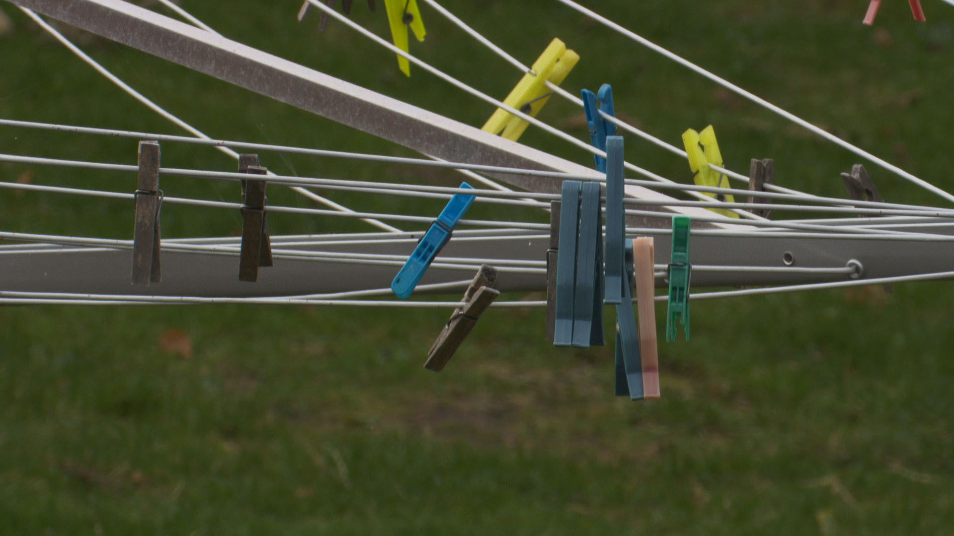

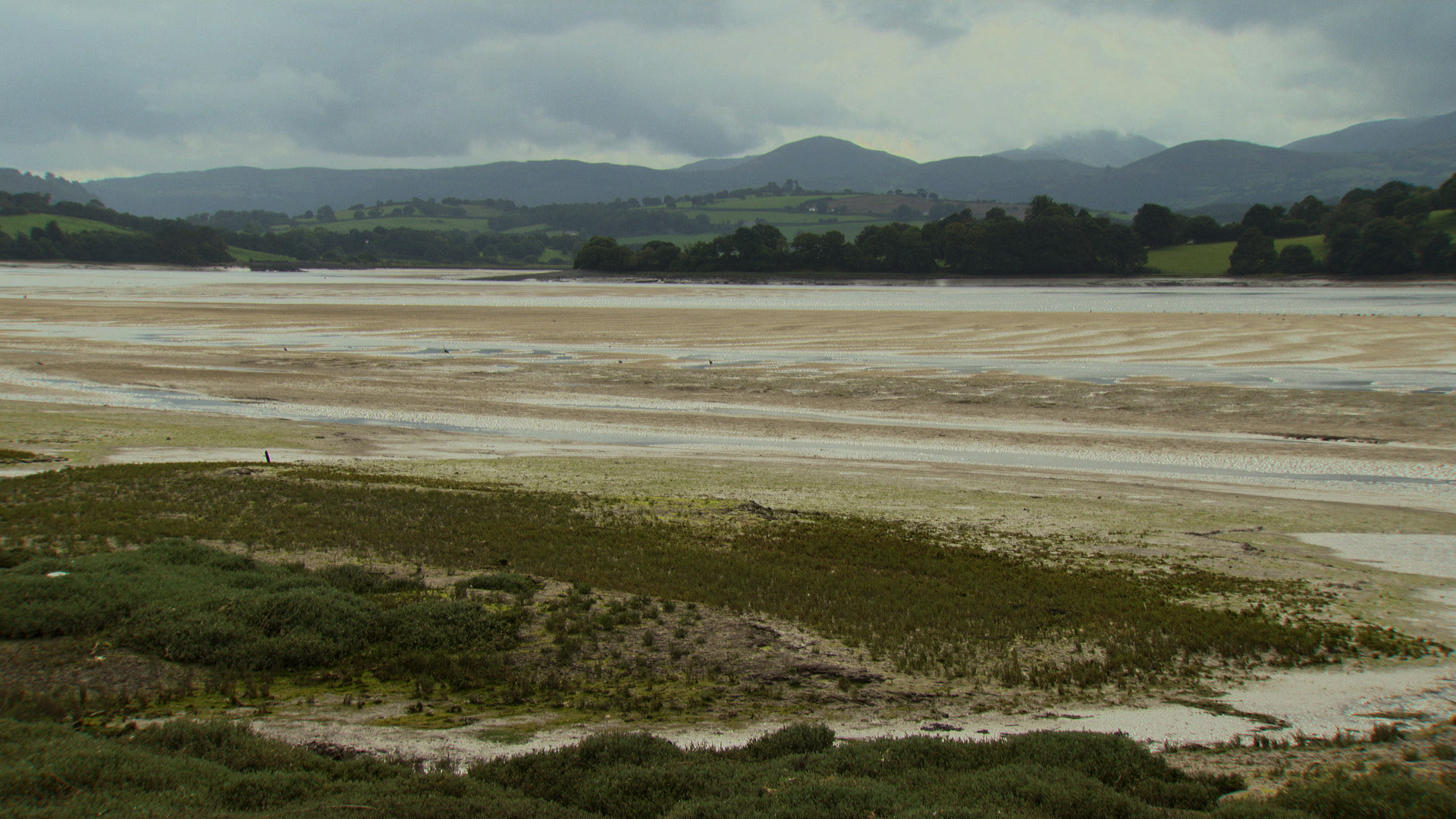

Here are some more side by sides. Lenses were Canon J14x8.5 and Canon HJ22x7.6. a1,b1 and c1 were with one lens, a2, b2 and c2 were with the others. I CAN tell the difference, what do you think? PDW700, -6db, f5.6.
Steve

Old September 12th, 2008, 10:39 AM   #10
Location: NE of London, England
Posts: 788
a1,b1 & c1 appear sharper but seems to have worse CA on the clothes pegs shot than lens 2.

Old September 12th, 2008, 11:20 AM   #11
Location: Wales
Posts: 2,130
My thoughts exactly Mike, though the CA is not too different I thought. The J14 must be about 10 years old I guess. It's an IF one, not a really old fashioned job.
Steve
Old September 12th, 2008, 11:22 AM   #12
Location: Wales
Posts: 2,130
No, second thoughts, you're right, the CA in 1 is definitely worse.

Old September 13th, 2008, 06:49 AM   #13
Location: Scotland (UK)
Posts: 219
Steve - thanks for doing this stuff (and to everyone else doing these things), I am very keen on this camera, unfortunately I have not been able to get my hands on one up here in Fife, and I can't get the time to go to any of the shows.
I agree (from what I can see) that a1,b1, and c1 appear to be sharper - as for CA, I can't make a judgement on that with the monitor I am viewing this on.

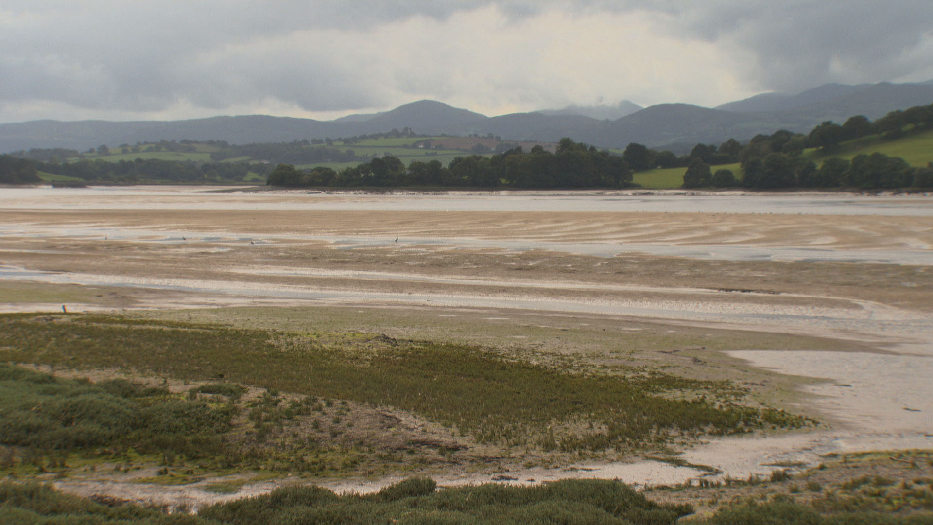

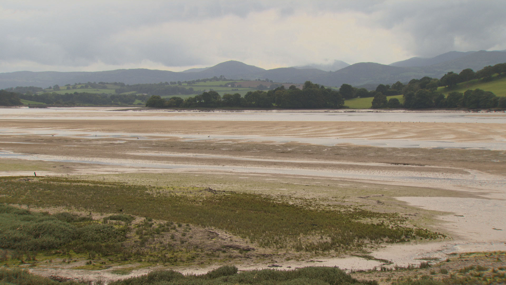

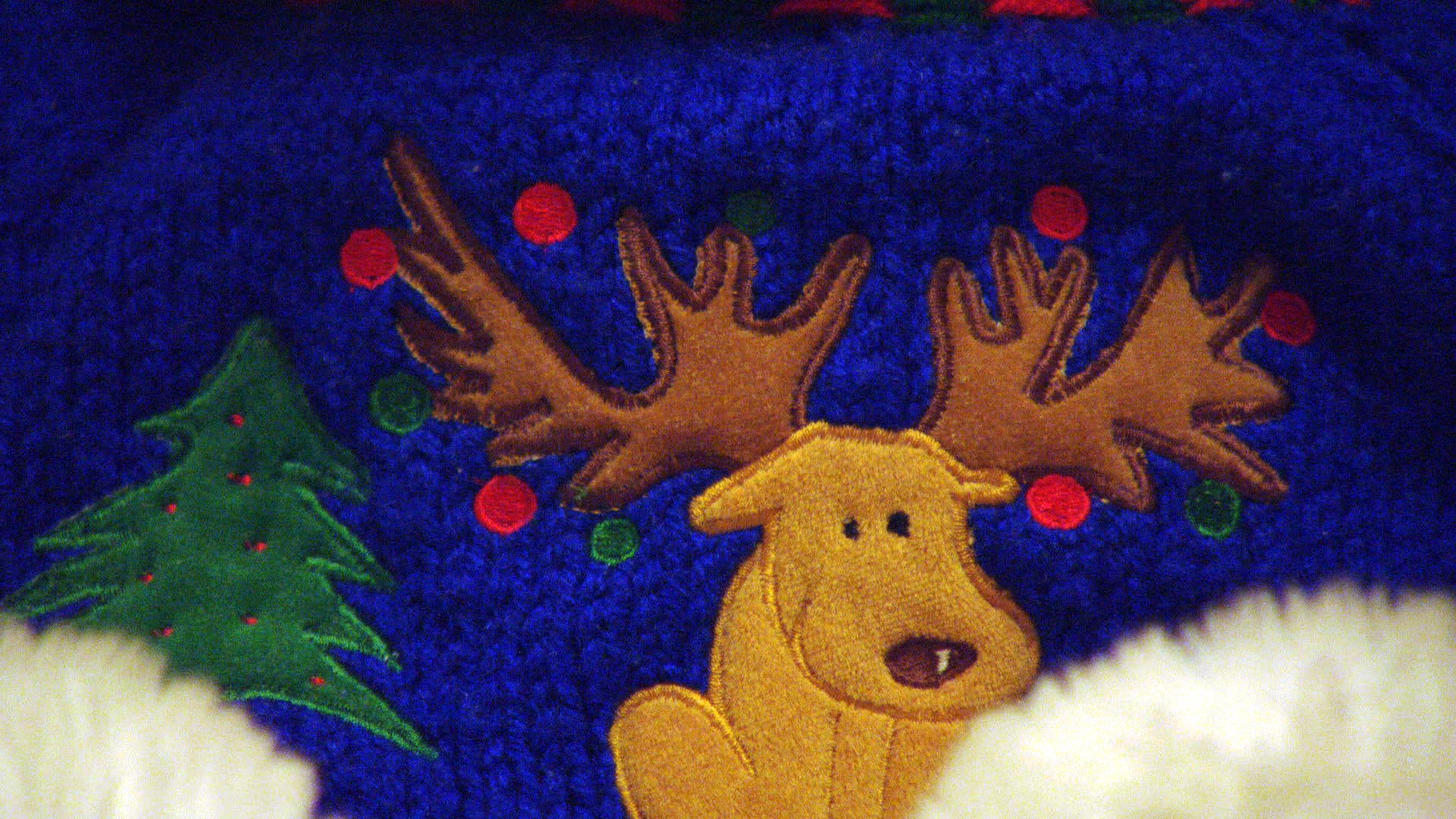

For those who are interested, here are a couple of grabs from PDW700 and F355 side by side. Shots 1 and 1b are PDW700 and 2 and 2b from the F355. Quite a bit of difference. Also interesting that the file sizes are so different, even though they are from exactly the same grabbing proccess, presumably just shows how much extra res there is there?
Steve
