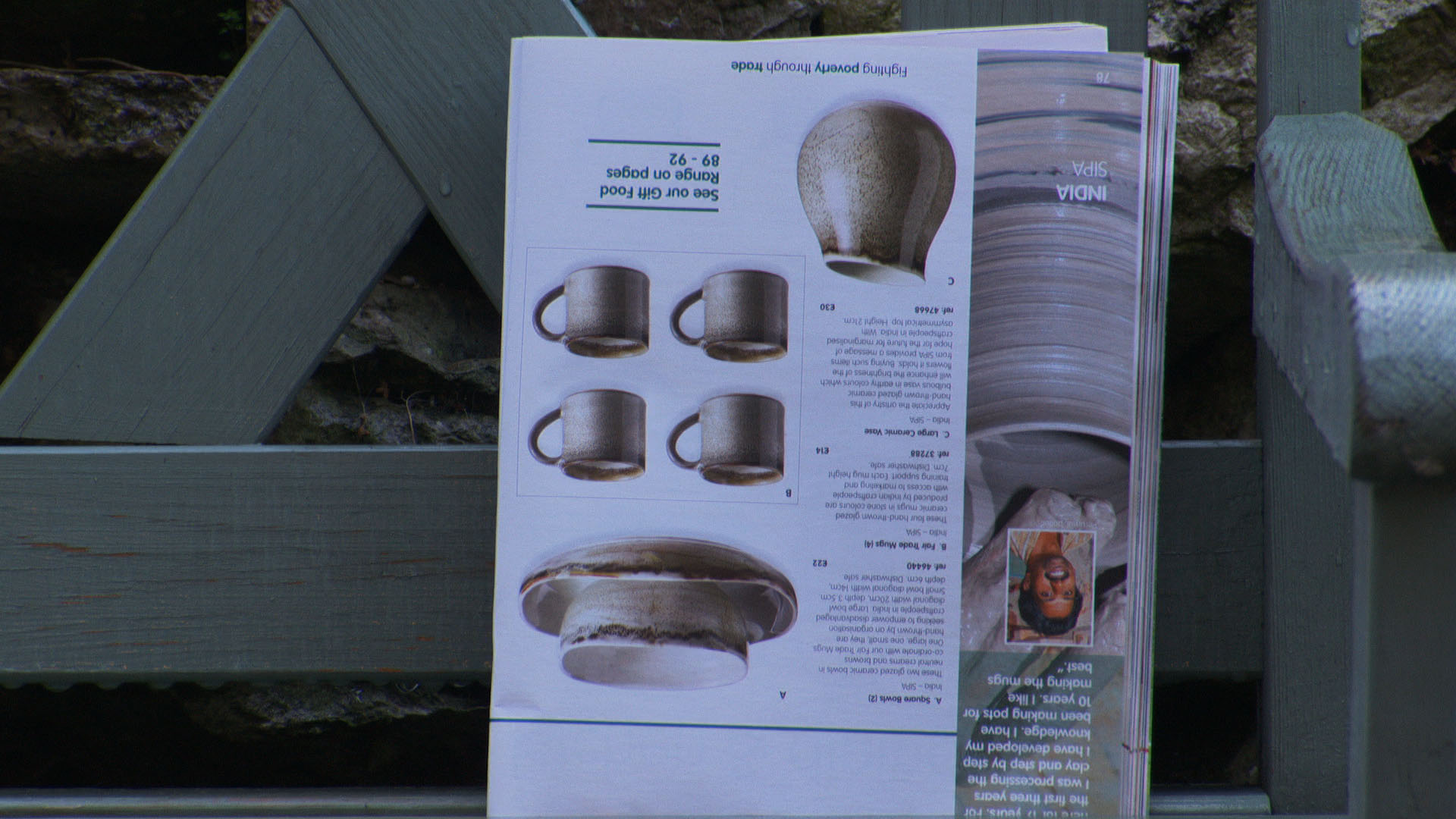

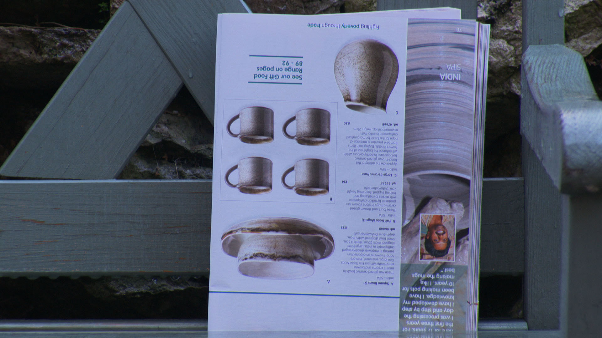

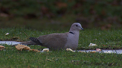

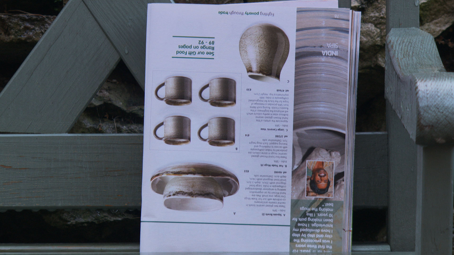

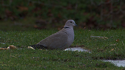

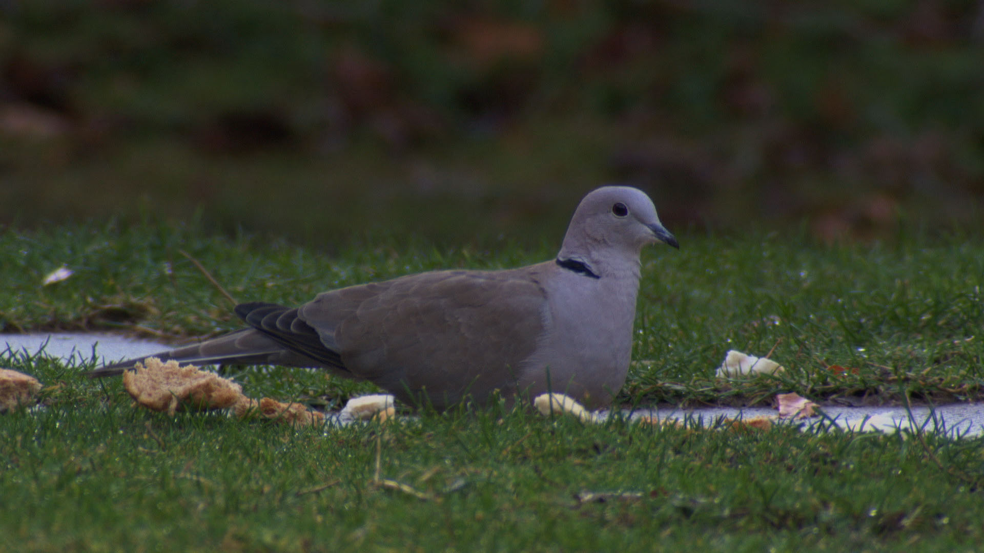

How is my testing methodology? I shoot on PDW700, send them to FCP and view 100% and 400% crops. Presumably this should give me a fair idea of the performance of a lens, every bit as much as viewing on a big HD screen, or am I missing something?
Steve
Old December 4th, 2008, 10:25 AM   #15
Location: Wales
Posts: 2,130
More lens tests
More tests, PDW700.
Comments, will fill you in on what's what later.
Steve
