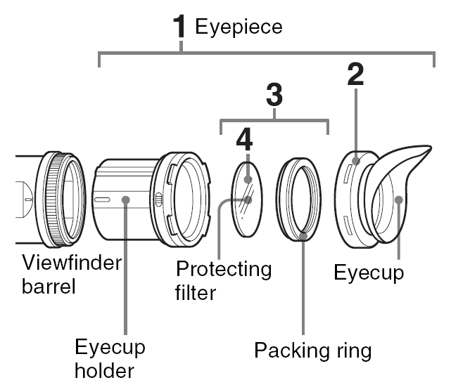

Andy, you're not the first one to mention the trick of using a 52mm diopter glass in place of the standard. I've been meaning to try this for my F350 viewfinder.
-gb-
I saw this idea on the forum of using this on a sony viewfinder. Can anyone tell me how you attach it etc?
You would carefully remove the existing eyepiece lens and sub it with the other one.

So, if I remove the Protecting filter (nr.4) and place the Tiffen 52mm close-up filter instead this should be working?
Do I also have to remove the metal (or whatever it's made of) ring from the Tiffen 52mm filter for placing it inside the eyepiece?
The Tiffen close up lens set contains three filters: CU+1, CU+2, CU+3. Wich one has te be used? Or is this different for every person? On their website they also say that you can use them in combination for maximum effect. Any ideas?
