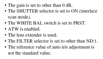

any of the following will cause it

Next to the menu switch there is another silver toggle switch called "Cancel/Preset/Escape". Flick that up and the camera's status pages will be shown on the viewfinder. There are four status pages and you can cycle through them by flicking the switch multiple times.
One of the pages is called "ABNORMAL STATUS". Any line shown on that page that begins with a "!" is the reason the warning light is being shown in your viewfinder.
