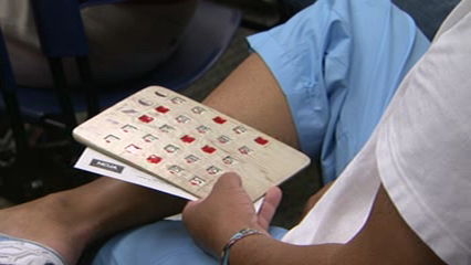

Good post, Peter. I would suggest looking at Cinegamma 4. That was the curve I really fell in love with when I first started using the camera. This curve stays pretty vertical for the most part, but rolls off the highlights more gradually than does standard gamma. This will help avoid blowing out the whites. BTW, that's using standard matrix, not cine matrix.
I've also used the FL matrix under standard overhead fluorescent lighting and had beautiful whites, with proper skin tones. Yes, her skin was that brown. It was August, in Texas, and that means well tanned.
