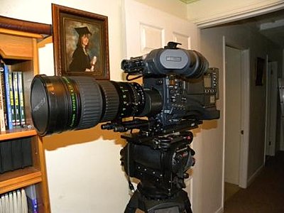

Here's the HJ40 on my plate http://www.dvinfo.net/forum/attachme...d-img_6695.jpg
Not my head here, I was testing out a Cartoni Master at the time (not that impressed incidentally).
Steve

It might be possible to mount the HJ40 without the Canon support thing, I did it with a Fujinon HA36x105 (see pic).
Steve

Thanks for the picture Steve I will give that a try. Lowering the VCG will make a huge difference to the head performance.
Yea the Vinten surprised me when I checked it out at Abel Cine Tech. I was expecting to go a different route but it tested great and the Fibertech sticks are a dream in the field.
The Fujinon in the picture has a huge focus ring.

I wouldn't get rid of the Ronford plate, I'd not use the Canon bit. It should fairly easily be possible to support the HJ40 on the Ronford bars, as I did with the Fujinon in my pics. The added benefit there is that it's simple to change from the HJ40 to a normal lens.
Steve
