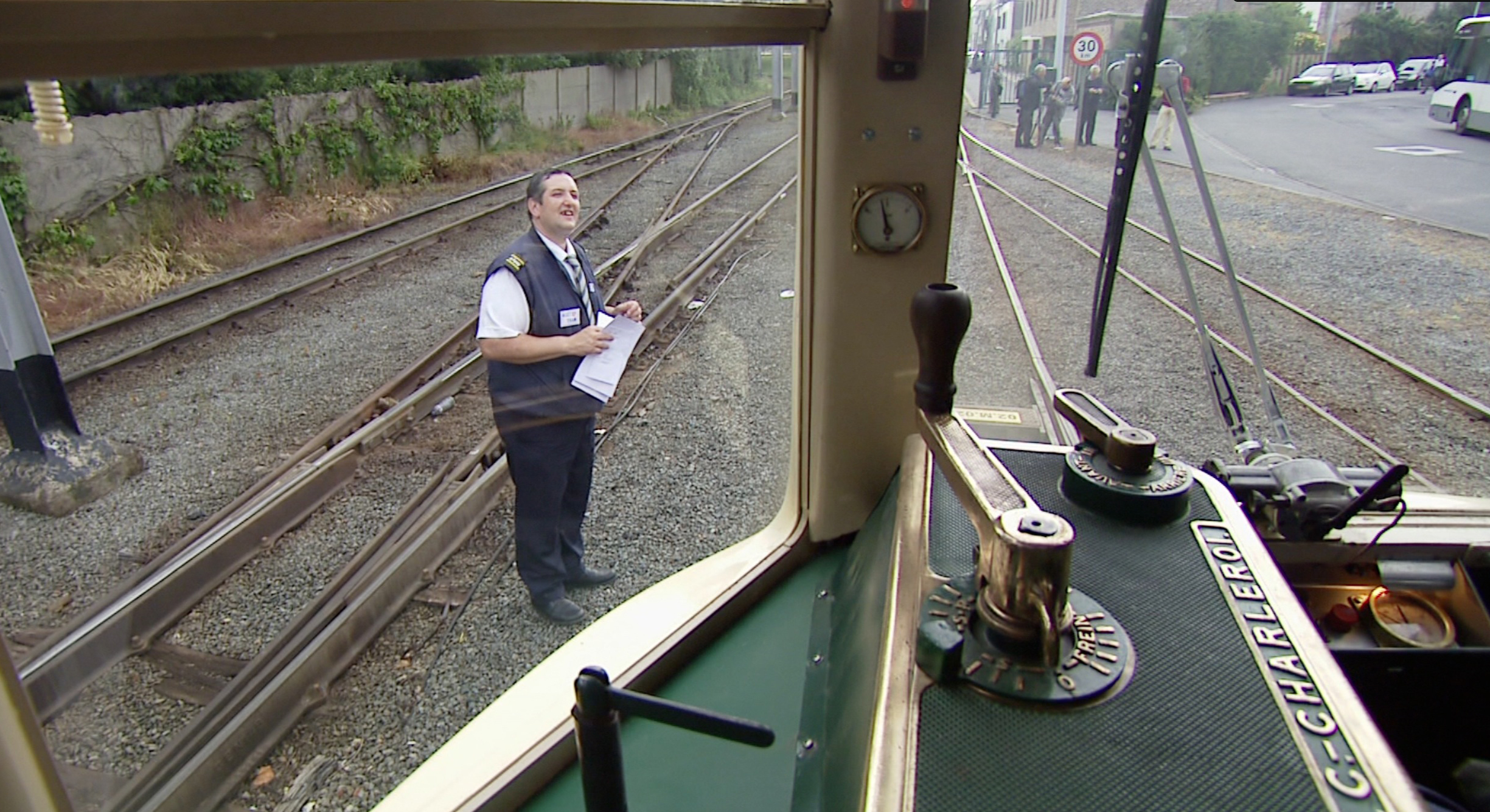

This is a screenshot form a clip made with the PDW-F350, at -3dB

What lens are you using Luc? Lots of CA. Looks like an SD lens or Canon KH20.
You might want to consider raising the detail frequency to reduce the thick black detail correction edges that are pretty typical of a F3**
Is it just that shot or is the image sharper on the left than the right? Could be the collimation is out on the lens. The CA is worse on the right than the left too.
Old January 24th, 2011, 02:12 AM   #27
Posts: 963
Hi Alister,
the lens is the KH10e x 3,6 IRSE SX12, at it's widest angle, which is not the sharpest or best position, especially in the corners.
Sorry for my ignorance (my business is stills photography, in video I'm just an amateur) , but what do you mean by 'collimation'? Not the flange back adjustment, I presume, because that is perfect.
I'll certainly give it a try raising the detail frequency to reduce the detail correction edges. Any idea by how much? It's set to '0' no.
Old January 24th, 2011, 02:28 AM   #28
Posts: 4,957
Try +40 and see if that helps reduce those strong thick black edges.
Collimation would be a mechanical alignment of the lens, not something the user can do. It might just be the windows in the tram, hard to tell from a single shot.
Old January 24th, 2011, 02:45 AM   #29
Posts: 963

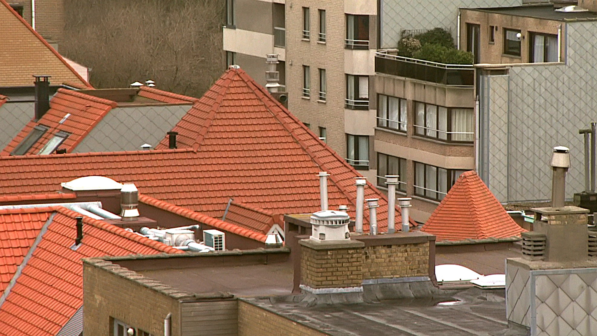

OK, I'll give that a try. Detail itself is set to '2'.
The CA is quite present, even extremely so in the cars in the upper right corner. But as I said, that's at full wide angle and aperture almost fully open. Even zooming in slightly makes the CA go away. My 16-35 canon stills lens has the same problem when used on my full frame 5D mkII. In fact, most Canon wide-angles have as far as my experience goes.
I understand the KH10e x 3,6 is one of Canon's better lenses, and when I compared it to a Fujinon, it shure came out the best of the two...

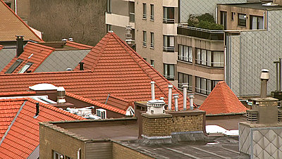

Edit: added testshot, full tele, f8, detail frequency +40, gain -3dB,... looks better.
