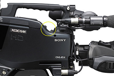

I'm not familiar enough with the PMW-350 to know whether it has the same kind of mounting system as the F800/700 or not. But on my F800, there are two screws on the camera body just behind where the front of the handle connects to the body. You remove those screws, and attach the CAC-12. In this photo, the CAC-12 is NOT on the camera.

Thanks for the photo....no, the PMW-350 does not have those screws.
