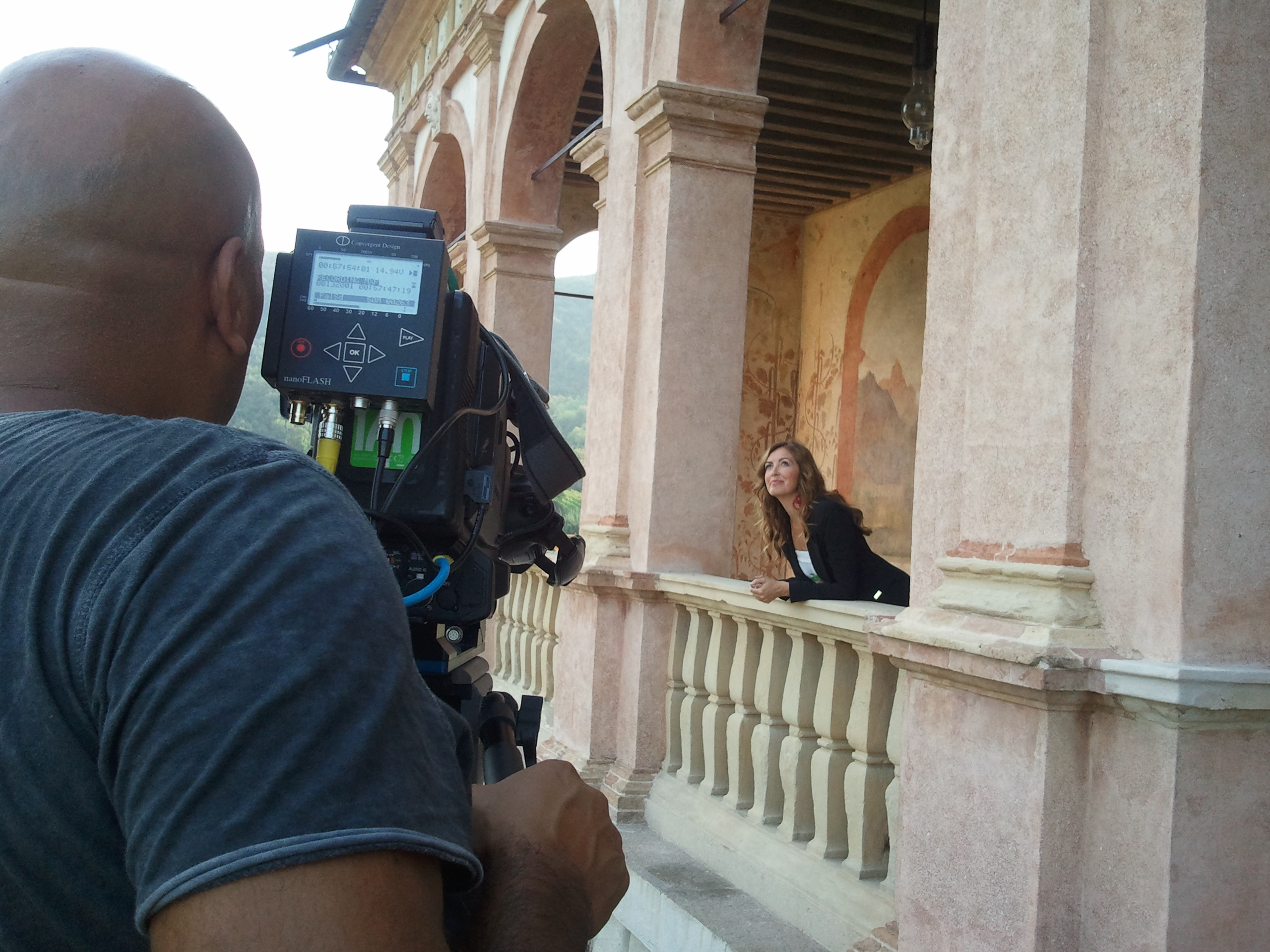

Hi Tim, I checked that also on my 350 and i can confirm what Luc said in his reply, the D-tap goes off after about 5 seconds after switching off the camera.and i can't switch on anything via D-tap with the camera off. i have also the nano flash but i power it from the battery directly via D-tap and i find it very usefull this way i can use the camera's D-tap for light on board or to connect my dp6 monitor. i always keep the power save mode on in the nano flash and it works perfectly for me,with my battery i can power camera and nano flash for more than one day shooting...it's incredible how little power camera and nano consume...you can see it in this picture.
Samer
