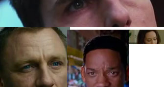

I seldom shoot sikintones over 50 IRE.
And than I even bring em down in post a bit, to give em texture.
Load any major blockbuster into your NLE and measure skintones. They mostly live around 35-40 IRE with a bit more in the highlights.
Only in low key scenes maybe, 35-40 is very low for normal scene. Most normal lighting scenes would be 45-60 for non shadow areas even in blockbusters.
Old July 29th, 2012, 08:14 AM   #27
Posts: 4,957
Re: Hyper Gamma 4
I've attached some small images cropped out from recent blockbuster clips. If you load them in to photoshop you'll see that the non-shadow skin tones range from around 45-60%, even the night time Will Smith shot reaches 48%. Yes some movies go lower for particularly dark scenes but 35-40 is not a normal exposure range. The movies are Mission impossible, Skyfall, Salmon Fishing in the Yemen and Men in Black.
