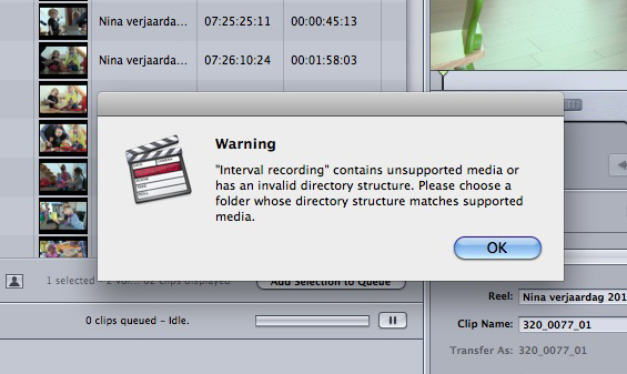

I'm trying to import some older XDCAM clips, originally on XDCAM disk, but now archived on hard disk, in Final Cut Pro 7 but that does not work. I've tried several ways: as 'import file' but then none of the files are highlighted so I cannot select them; via 'Log & Transfer', but the clips do not show up in the transfer window; via XDCAM Browser and 'import into FCP' but apparently the browser searches for FCP-X that I do not have nor use, ... so I'm stuck here. Anyone have any ideas? I need the footage for editing together with some newer XDCAM-EX clips..

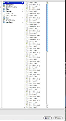

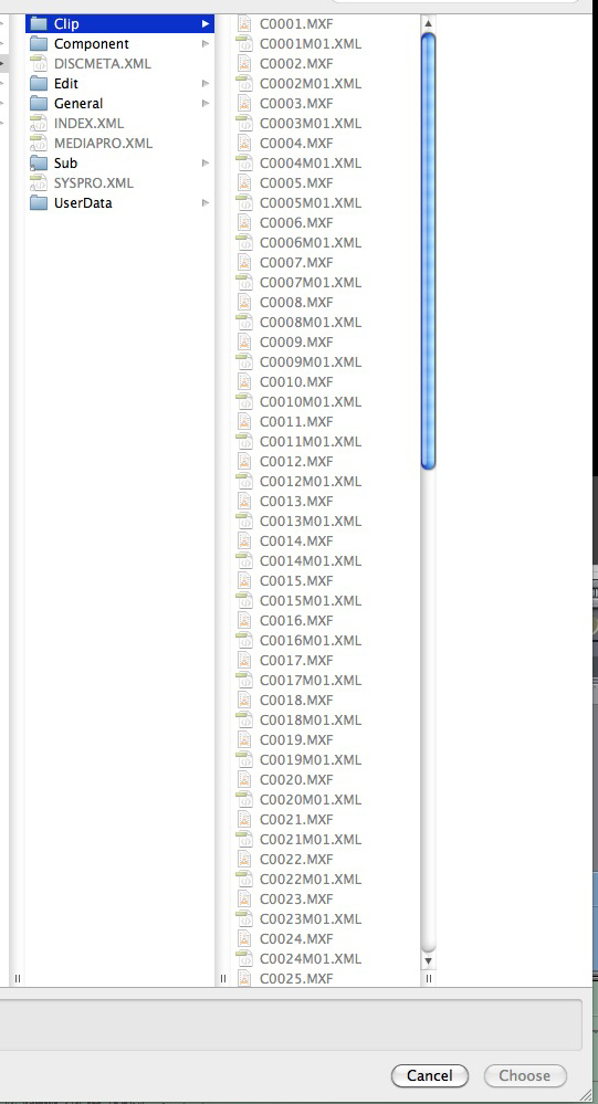

Some more info: this is the file structure on the back-up hard disk. I don not have the original XDCAM disk anymore.

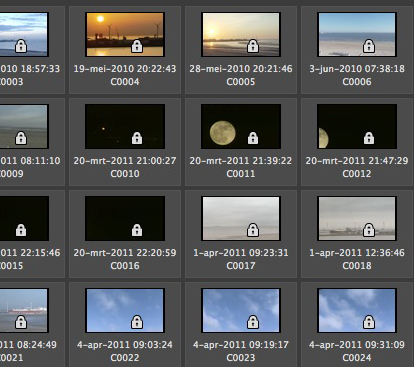

In XDCAM Browser, I have ticked FCP7 as my preference, but the clips appear 'padlocked' (see screendump) and when I right-click one and choose 'Import in FCP' it starts to import but nothing shows up in FCP. Instead I find the clips (as .MOV-files) in a folder under 'movies', 'Sony' and 'XDCAM'. From there I can import them via 'import', 'files' in FCP, but I'm sure I could do this a shorter way in the past.
Importing archived XDCAM-clips in FCP7-bax-fcp-log-transfer.jpg   Importing archived XDCAM-clips in FCP7-xdcam-browser-padloc-d1ffe8.jpg

I think the clips are marked with padlocks because these have been marked with the "keep" shot marker. Xdcam browser will not delete clips marked as "keep".

Thanks for the extra info, Alister. I worked the other way round, by starting up XDCAM browser first, but I tried it your way and that's clearly more practical. The padlock icon doesn't really bother me, but I was wondering what it may mean. I don't remember ever marking clips in any way, so I have no idea where it came from.
